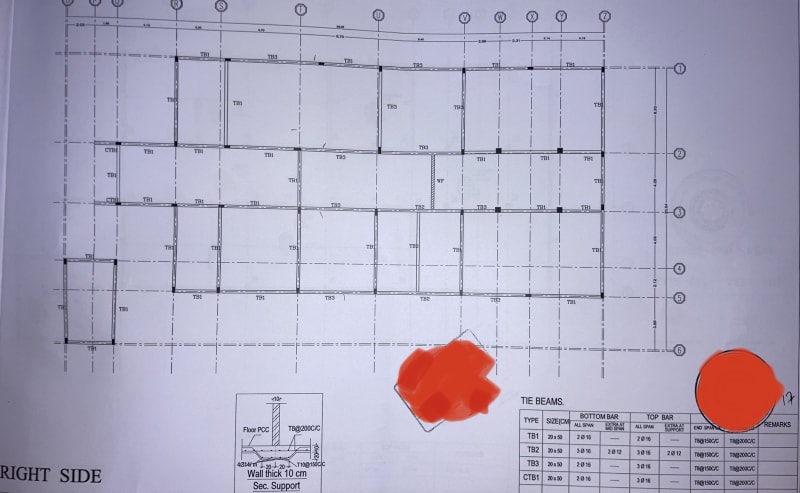

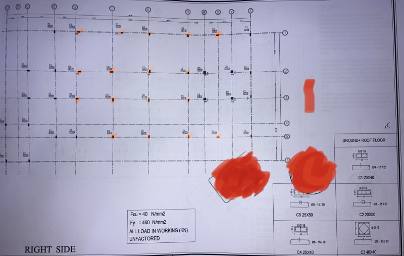

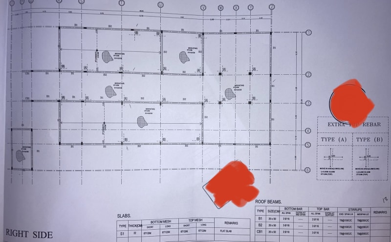

Here are the drawings which are approved for construction at site(please ignore the mark ups as I don't want to share the regional/company details).
The marked columns need amendment.

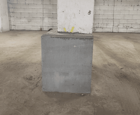

I've never jacketed anything for a structural purpose without some sort of additional reinforcing steel to add confinement. Jacketing to add cover, sure. But to increase strength? Never seen that without steel.
Anyways, here is a picture of a jacket on 2 sides of a column that I did a few months ago. I'll find the engineered details from the consultant and post later once I find them in the archives.
Thanks for sharing your experience.
