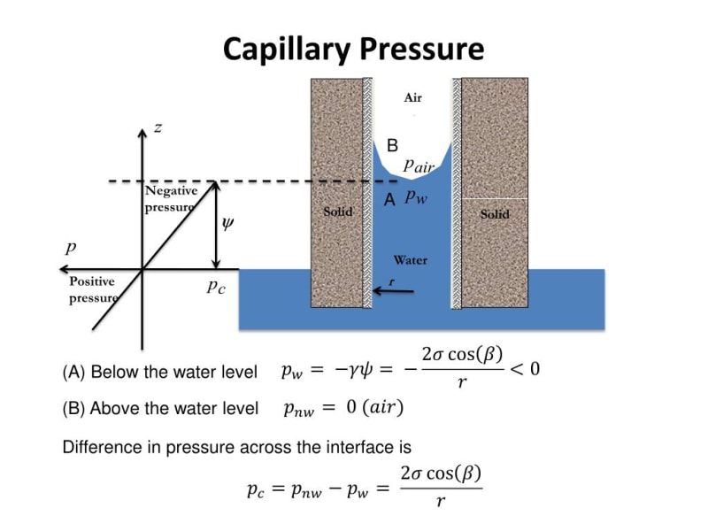

I can imagine that the pressure being equal and cancel out at the center of the glass. It was just hard to accept the fact(I will exaggerate a bit) that the lateral pressure on the perimeter of 5 mm diameter & 100 mm deep glass and 500 mm dia & 100 mm deep glass are the same. [spin2]

The water pressure on the perimeter of 5 mm diameter & 100 mm deep glass is less than the 500 mm dia & 100 mm deep glass due to capillary action.
