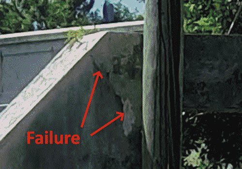

Hi there, I've been tasked to design a solution to fix this problem (see attached images)
The problem:
1. Existing concrete beam-column on top of the buttresses has experienced corrosion of the inner steel member that has expanded and caused delamination of the concrete, which is now falling onto the motorway beneath it (The existing has lasted about 50 years).
The road is closed until this issue gets resolved.
2. Historical drawings of the road are not available and they are expecting a quick solution. Therefore conservative assumptions need to be used.
The solution:
I thought about potentially saving the beam by using some bolted channel sections but not sure if those would be adequate in compression and the quality of the beam concrete seems poor, so I will just replace them, which the client is happy to do.
I am thinking of using a concrete-encased steel H beam. I am assuming the buttresses are in adequate condition and plan to use those for the new beam. I am planning to replace the beam with one of the same cross-section dimensions so that the overall weight of the beam is not higher than the original.
I am wondering how I can connect this new beam to the buttresses so that the connection can effectively take the axial compression loads etc. Essentially I would like to know what the most efficient connection detail to transfer the force from the beam to the buttress is.
I'm roughly thinking of some type of system using post-installed anchors in the buttresses, bolted to the beam flange and concreted over?
I'm not sure if there is a common connection detail for something like this or not. If anyone can provide assistance or point me in the direction of helpful advice applicable to this design, that would be greatly appreciated.
Beam-column has a clear span of about 16', with a depth of 1'8" and width of 2'.
It's a strange structure as the steel inside the beam-column appears to be an old train track?
I am also assuming that these beam-columns are acting as lateral bracing for the adjacent retaining walls.

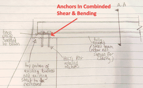

D)I agree with the galvanizing and I think using a simple steel beam would be the simplest and most cost-effective approach (especially as no formwork is required). However, the site location is in a very humid and corrosive environment that tends to corrode steel quickly(even galvanized). Due to this, I was considering doing a fully encased steel beam in RC concrete (see my sketch) mainly from a durability standpoint. I'll probably propose both to the client and let them decide what they want to go with after I explain the durability differences.
E) See my sketch of the detail I am thinking of. Would you mind giving your advice on this? The compression force in the beams seems to be somewhat small ~150kN; I was going to design the connection anchors to be able to resist that in shear. Are there any other significant design effects that I should be considering for the connection?
If the buttresses perform as normal there really shouldn't be much compression going into these struts as they shouldn't be bending but I am assuming the worst case (buttress fails).
The detail in my sketch may work ok for good concrete but I am unsure what sort of connection should be used if the existing concrete is bad when the strut is removed. Any help would be appreciated.
 https://files.engineering.com/getfile.aspx?folder=ca229342-d06e-43f3-a8b3-8daba0ce7645&file=20210827_204752_-_Copy.jpg
I'm not convinced that steel with a RC protective layer is cheaper than just straight RC. I mean, the way you have drawn the encasement I gaurentee you the GC will be hiring a proper forming contractor. So...no matter what a forming guy is coming to site. You are paying for a pump. You are paying for concrete. You are paying for designed falsework. Why not just make it a reinforced concrete beam?

Does the detail in the attached sketch seem reasonable?
As for the design effects in the steel bolts, yes parent concrete break out will most likely govern (that’s one of the checks I would do with regard to the shear – the hilti tables take that into consideration and gives the respective shear capacity of the bolts). The edge distances may be a bit of an issue that I will need to check. Frustratingly enough, there are no historical drawings for any of this structure, so I need to assume that the buttresses are mass concrete.
Would you mind explaining a bit more about the correct detailing for anchor bending? I would have thought that you would only get bending if there was a gap between the baseplate and concrete layer?
Thanks for the tip regarding bad concrete, I will use that going forward in my career. When deciding on whether the parent concrete is ‘acceptable’, am I mainly checking for obvious issues like cracking, spalling, honey combing and delamination and keep chipping away until it is solid with no visible issues or is there another check that should be done? For the calculations I’ll assume the worst grade of concrete 2500 psi (17.2MPa).
As for the concrete repair detail, I have done a search for some good literature on the topic but I am having a hard time. I would have thought that for the joint between the old concrete and new concrete, would be a bonding agent and either the anchors in the first sketch or post installed rebar in the second would act as dowels tying the two layers together.
Any assistance or sketches you can provide for optimal connection arrangements would be helpful.

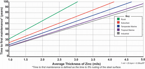

Also, I continue to disagree with using a concrete-encased HP. You have discounted hot-dip galvanizing, but when correctly specified (required zinc coating thickness) useful life is lengthy, even for humid, corrosive conditions (such as the coal-fired electric generating stations, located on the hot/humid South Carolina coastal plain, where I worked)
An HP that is not concrete encased will be significantly lighter than the same member with concrete encasement. Lighter mean less bending due to self-weight - a good feature for a compression strut. Connections can be much simplified, too.

Can you use an HSS section in lieu of a rolled one? There are zinc-rich epoxy coating systems that are much better than HDG. For expediency, I'd avoid a reinforced concrete solution.

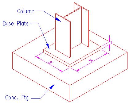

Redacted - Because of your time constraint, I'll post the "bottom line", without explanation. Look it over, think about, post to let me know you have seen it, and we can discuss it tomorrow.
Note: Although what I am proposing is based on speculation & assumptions about how the existing project was designed/constructed, it may be a reasonable solution that has many advantages:
Take this:
Then, rotate all of it 90 degrees (including the "Column Ftg." which now represents the "Existing Retaining Wall")
We can get into why tomorrow.

Redacted - I'll see if can answer your questions:
Other Benefits: You got most of them, but there are some that are more subtle:
Simplified design/construction. I have found, in general, that the higher the loading the KISS Principle becomes more important.​
The strut can easily be designed to have a generous safety factor. Normal rules for economy of design go out the window when working on heavy structural repair/modification. You may kid yourself, but you don't really know the loads; don't want failure because you overlooked or undersized something (just to "save" a few pennies). For heavy structural, I did not have legal risk (but did have technical responsibility) as an electric utility employee to keep our generating stations online. As a consultant, legal is probably more important to you.​
No significant modification of the existing structure required. Don't make any more changes to an exiting structure than you have to. If you do, can get unintended consequences.​
Distributes the load on the existing structure over a "large" area. Just like the unknown loads mentioned above, you also don't know the capacity of existing members that will be loaded. Compare the size of the footprint of the baseplate on the wall to the size of wall where Hilti anchors would be installed with original beam-bearing approach.​
Struct Replacement: Easy, when the reaction anchor is rebuilt, design it with a (structural steel or formed concrete) "slot" or "pocket" that seats a similar baseplate at that end. To replace, lift that end of strut out of the "slot" and pull it, axially, off the Hilti anchors at the wall end.
Edit: Actually, removing the strut is even easier... after installing temporary strut(s), cut it into pieces with an acetylene torch. The above procedure would be to install a slightly shorter replacement strut. Use grout at the reaction anchor end to fill the small gap.

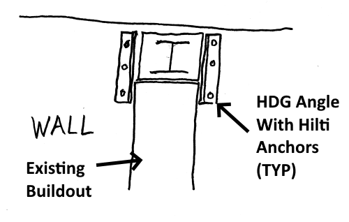

Hilti Anchor Purpose: I would have weight of the strut bear totally on the "build out". If you have to replace or enlarge the build out, do so. The Hilti anchors are just to ensure it stays there. When axial load is applied to the strut, it's not going anywhere.

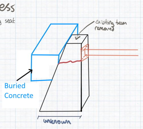

There are a few issues that I am still trying to work out that hopefully, someone can assist with:
1. The connection detail that you show above should work for the connections where the buttress is below the wall level (has a bearing seat, see attached sketch). However, in one location the buttress is above the wall level, so there is no bearing seat for the beam (see attached sketch). I could attach the beam to the wall plate connection without a bearing seat and have the anchors hold up the weight of the beam (on the one side without the bearing seat) but doing so would cause a reduction in the vehicle headroom clearance below, which may be a problem. Is there a simple way to maintain the head height? I see your note, where you say increase the build-out of the buttress; unfortunately, this can't go farther into the road.
EditI could also potentially cut into the buttress to create a 6" or 8" bearing seat but I would not want to reduce the depth of the buttress by too much where shear failure would become an issue.
2. With the same buttress above the wall height with no bearing seat, I am concerned about the shear capacity of the buttress at the tip, as I want to avoid local shear failure. I am unsure how best to go about analysing this if assuming unreinforced mass concrete? I’m not sure if I can analyse this like a normal beam? ACI 318 has guidance for the shear strength of rectangular cross sections (22.5.4) : ΦVn = Φ x 4/3 x λ x sqrt(f'c) x b x h. I’m unsure of what the cross-sectional area (more specifically d) I should be taking for that formula, as the structure tapers. If considering a 2’x2’ square it ends up having a shear capacity of ~100kN. I’m unsure if I should be relying on this concrete shear strength or if I should include a few post installed rebar from the top down that would shear capacity for the load? (See attached sketch).

Redacted - How many struts have to be replaced? Since they seem to be all different, address them one-at-time. You may have a different design for each one.
Also, you need to try to find out shape and thickness of the wall is at each strut location. Don't have to go full depth, have a backhoe dig down a reasonable distance. If you can't do that, have a rebar driven (with a sledge hammer) at each location to probe and see is you can get an idea of wall shape. Blind guessing is not good. As mentioned previously, make complete use of the "full-size, three dimensional model".

I went to the job site and took additional measurements this morning to get a better overall picture of the structure, see attached.
There are two struts that need to be replaced.
In the one location (top left of strut 2) the masonry stone wall above grade appears to not be a retaining wall. You can see the change in material from old to new. It appears that the stone wall in this location may have just been framed around the buttress (not actually connected to it structurally)?
The strut connection where it is bolted through the buttress/wall seems fine for the connections of the right side and potentially the connection on the left side for strut 2. However, the left side connection for strut 1 will perhaps need a different solution.

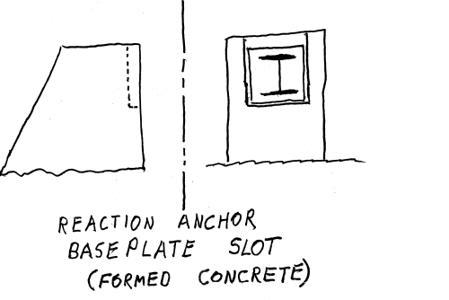

Here is a sketch of my concept of a reaction anchor bearing plate "slot" or "pocket".
After thinking the requirement to make the struts replaceable, I would not put any Hilti anchors through the baseplates, on either end of a strut. Instead, on the wall end create "slot" with steel angles and Hilti anchors. If the second strut does not have an existing buildout, have the structural steel slot fabricated with an angle across the bottom (to support the HP/baseplate).
I would use grout on the reaction anchor ends, but for the wall ends... a neoprene pad instead.
What size HP and base plates are you considering?
EDIT: To increase shear capacity of exiting concrete wall, pour a block of new concrete behind and directly contacting the existing wall:

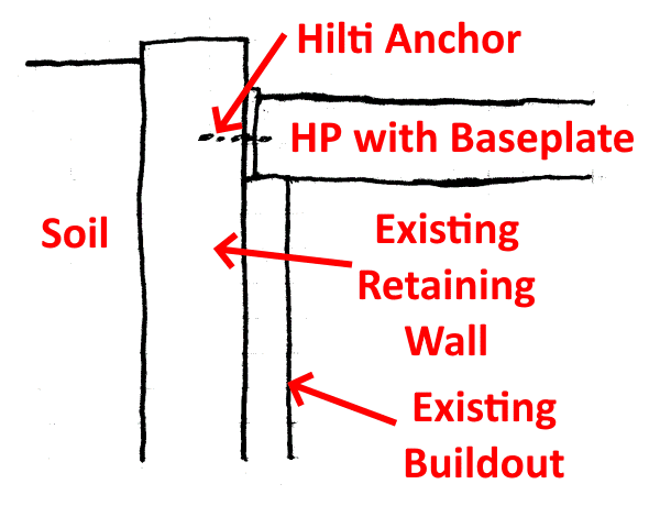

Hi SlideRuleEra,
Firstly thanks so much for your assistance with this. I’m learning quite a bit on this project, which makes it even more interesting.
I was playing around with potential plate configurations in HILTI Profis and will most likely consider a layout as shown in the attached image.
For the plate and anchor design, I conservatively assumed no bearing seat in the event that the bearing seat failed. The strut axial compression load was acting favorably (pretty much negated the bending and shear effects on anchors) so I conservatively omitted it for now, which seems reasonable as I don’t think the strut will take any compression loads until the wall slightly rotates and engages the strut.
Beam size I am looking to go for is W12x45 (oversized for the loads I estimated but as you said there are a lot of uncertainties and the cost increase is marginal), plate size 16”x16”x0.625” with the plate going against the 24” wide buttress.
4x 5/8” HILTI anchors embedded 6”.
What are your thoughts on the attached?

To increase the shear capacity, it would be nice to put a mass concrete anchor behind the buttress but unfortunately it would be required for the buttress to strut 1, which is above grade. The mass concrete would be highly visible. Perhaps it needs a more discrete option. One approach would be to lower the beam on the buttress and gain a larger depth of concrete, therefore increasing the shear capacity. However, I would need the client to agree to reduce the head room first though, which they may not be willing to do.
As for the replaceability, the client expressed that they would be fine for the beam to last 25 years, after which they would look to start doing strengthening or replacement works to the retaining wall and buttresses. So, bolting the anchors through the base plate should be fine, as it may be the simplest approach. I should be able to use the attached detail for 3 out of 4 of the connections and a potential modification (cut out a bearing seat or put in a bolted angle seat underneath flange) for strut 1, left connection.
What is the reasoning behind the neoprene pad(I'm not familiar with neoprene under columns, I would've thought it is mainly for vibration dampening)? Is it to allow for minor movement? Thermal expansion movement is quite small (~2mm for this span). Is this required?
