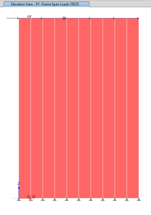

I have this 200mm x 3000mm cantilever wall with 100kN in plane point load at top.
From q = VQ/I I expected the shear flow is 0 at edge and 75kN/m at the middle. However, FEM gives me around 60kN (ie 20kN/m shear flow) at the edge. Where did I do wrong?

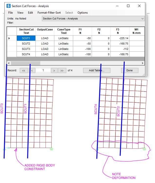

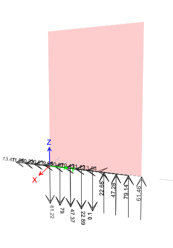

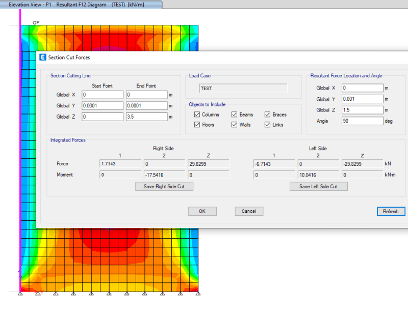

I believe it is your base restraint. Below I have two models. One that I think is similar to yours (right), and a second where I included a base constraint.

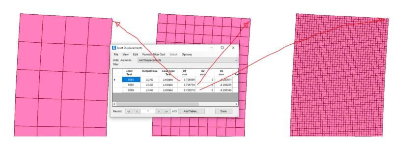

As for restraints issue you mentioned, I used the default setting 'Add Restraints on Edge if Corners have Restraints' so where the mesh nodes are the restraints were already applied. This can be verified by the reactions shown below.
That said, I have split the shell into 10 to create more restraints and I also reduced the mesh size.
As suggested, I changed the loads from point load to a 50kN/m line load on top by using 100x100 dummpy beam.
Still, I have around 30kN/m shear at the edge.

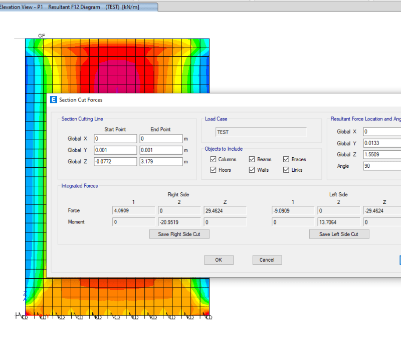

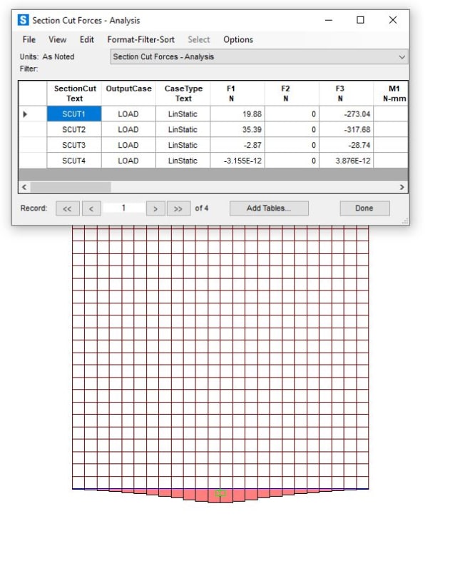

But both SCut3 & SCut4 shows non-zero force F3 in your model as well.
By having a series of pin supports along the bottom edge, you are forcing the shear strain in the wall to be basically uniform at the base, which is why the bottom edge is mainly orange coloured. I believe a series of springs in the horizontal direction would get you somewhere closer to the theoretical elastic shear stress distribution (i.e parabolic) at the base.
Likewise, at the top of the wall, you have applied a uniform line load which does not reflect the shear stress distribution in an elastic beam.
Towards the middle this obviously gets somewhere near the elastic behaviour of a beam, which is Saint Venant’s principal in action. Same thing when you applied a concentrated load in the initial case.
what FEA code are you using ?
"But both SCut3 & SCut4 shows non-zero force F3 in your model as well." Hmm, too early I guess.
I think gusmurr is on the right track. I altered the base constraint using a fixed connection and beam element at the base. By altering its dimensions of the beam the F3 value is nearing the solution, but not quite correct.
By refining the mesh the result is closer to correct. I am out of time for this thought exercise.

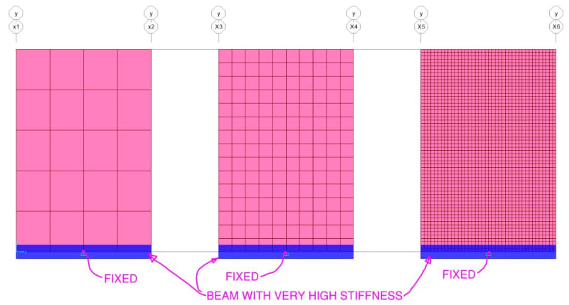

Can you please show me how you assign the base constraint?

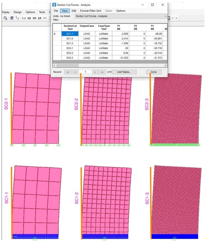

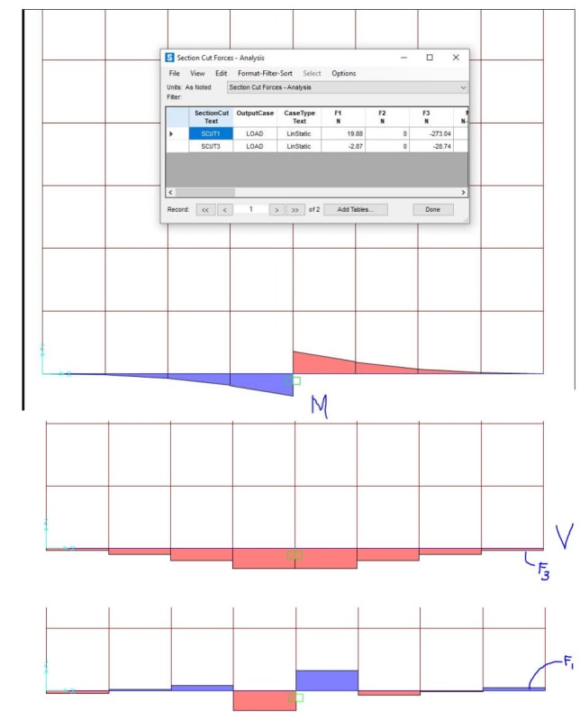

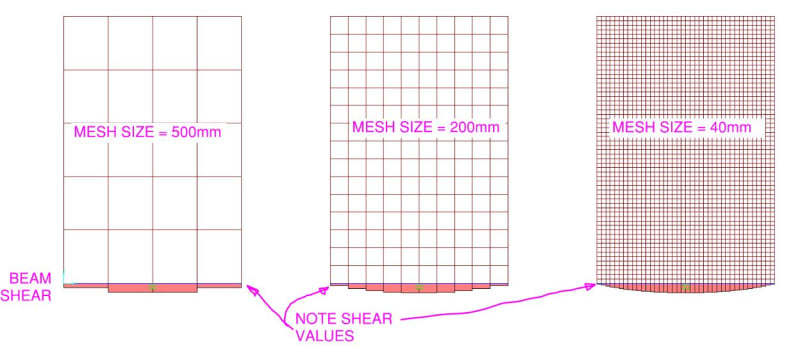

I only have a fixed joint at the middle of the wall. There is a very stiff zero mass beam across the base to replicate the fixity. You can see the shear in the beam is approaching what gunsmur describes as the mesh is refined.
Model images
Shear in beam.
Comparison of the deflection of the fictitious wall.
Section cuts comparisons using the beam at the base compared to pinned base walls with varying mesh density.
Reducing the mesh density in SC1-3 a little more the F3 value is 0kN. Obviously not a practical approach, but mesh sensitivity can be important depending on the goal of your analysis.

I did divide the elements in SC2-3 by two and the F3 value you are interested in changed from 16.7kN to 5kN. One would never do that in practice, so it is merely a thought exercise.
I think you need to ask yourself what you expect for forces in a panel like this? The dimensions of this are more like a squat wall rather than a flexural element. There have been many FEA studies where they have replicated actual test data using NLFEA methods. Study
Thank you Brad. I am looking at the last picture you uploaded and I can see the F3 in your SC2-3 is around 31kN, which is similar to mine and I believe the mesh size if your SC2-3 is small enough but don't know why a close to 0kN result is still not achieve even if I assign spring instead of restraints.
