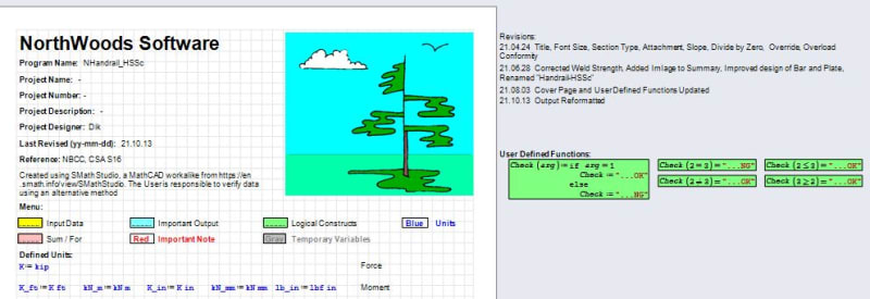

I use SMath... even for simple calcs that I want to retain, and print off the page(s) using DoroPDF writer, also a free add-on that works like a printer driver and save the *.pdf copy to file. If the calculation is one that I will use several times in future, then I write it up as a real program.
I often use SMath for conversion... this little clip shows how you can enter a value, and by changing the units it automatically converts just using the "=" key and change units. I use this often... the metre is the default and no unit change is required (used lots for conversion) works with forces and everything else...

and a couple of other items I use with SMath... stuff that is off the page, does not print.
and I can use Windows 'snap shot' to paste information directly on the page, or off the page. None of the stuff to the right will print... including the stuff from Roarks won't print unless it's on the page.

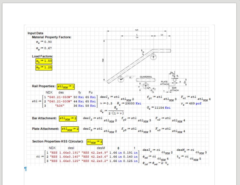

Dik I don't know how you get so many images and snapshots to appear in your program and not have it bogged down. My experience with SMath and MathCAD have not been successful in having many snapshots within the program. The sheet will also reach an event horizon type limit where it just will error-out and shut down. I mainly use MathCAD/SMath to numerically check formatted or tabular results within an Excel sheet.
I've never had a problem with 'bogging down' and my programs are generally about a dozen pages and some in excess of 20... Maybe my computers are fast... nearly all set up for my son's gaming... even my laptops are fast. I do a lot of 'cut and paste' for my programs... the first page is a template I use for all of them...

You may find MathCAD works better if you bury stuff in areas and close them up. For example pulling section properties in from spreadsheets can be tidied up that way saving space and it used to be a tad faster for some reason. How big are your sheets though? 32 Gb of RAM probably helps too; I feel that such things are probably pretty inefficient on the memory front. If things get dire, I'm pretty sure turning off automatic recalculation will get you moving again - just recalculate at points where you really need to instead of each time you change an equation or a size here or there.

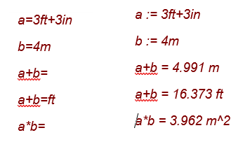

Thanks everyone for your comments... I'll try to answer some of the questions raised.
Equations are typed in as simple text. Equations are a paragraph that uses a particular style, so other text doesn't get accidently get entangled.
Equation are type as simple text. For example -
A_bolt=\pi*D^2=​
An underscore makes a subscript and the ^ as superscript. Word automatically converts \pi to π on the fly. This allows simple, fast typing and the use of cut and paste, with repetition. The document remains fast and small.
An Update button does the calculations, from top to bottom, still keeping in normal text. Any change can be re-Updated. This update is under a second for 100 equations.
The appearance of the equations in the document is as shown in the image in the original post. This is achieved by clicking "Format". The laying out of equations is adequate for code type equations. It doesn't use Latex, which is heavy and slow (but great for integrals, limits and other advanced formatting).
The layout of the calculation is "step by step", as you would do by hand. It is not a programming language with loops and if/else structures. It is up to the engineer to read the results and check no equation invalidated if parameters are changed.
Being directly in Word, you have access to all the other tools available. Printing to any printer is a breeze, you have spell and grammar checks on your associated text and lots more.
The attached plot show on the what is initially typed on the left and on the right, the result after updating. Note the mixed units, correct processing of units and on the 4th line, the result is directed to a particular output unit, feet. This is really useful just working in both metres and millimetres.
