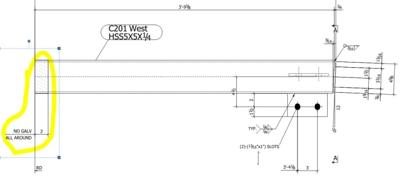

Here is some info on masking for Hot dip galvanizing (keep in mind, it doesn't only have to survive the heat from the kettle, it also has to survive the acid bath before that):
