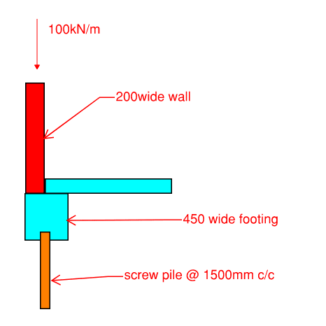

eccentric loads on edge strip footing that are supported by screw piles
JasonS_001
Oct 28, 2021
6
AU
Can anyone please give advice on the analysis and design (detailling etc) on this eccentric loads applied on the edge beams that are supported by the screw piles? Thanks
Screw piles generally have no lateral/torsional capacity to speak of as they are comprised of very small steel tubes. You can get them with larger HSS tubes, but they come and a significant premium.
For this case, you should probably either move your grade beam below grade and center it under the wall (best option) or, if you can't do that, design your slab as a diaphragm to resolve the moment and design your grade beam for the resulting torsion.
Talk with your local supplier and see if there is a typical detail to provide for eccentricity. Some screw pile suppliers provide a flat plate on top of the pile, but the pile must be capable of resisting the applied moment.
BA
Thank you.
Do you mean move the screw pile under the center of the wall? Thats what I was thinking but I wonder there will not be enough cover or room for screw pile to footing. Also, I have some small loads from the slab on grade as well. So it will be hard to find a perfect central location.
Can you please elaborate on this. I don't full get it. Thank you.
Is 150kN*0.125m = 18.75kNm torsion something rational for the screw pile to take?
Why a footing? Can you extend the wall down 300mm?
If I dont use footing how do I connect the screw pile to? And may I ask where 300mm comes from?
You use headed studs and cast the wall on top of the screw piles... done that lots of times... also with grade beams.

It isn't torsion. It is bending moment applied to the top of pile due to load eccentricity. 18.75kN-m is perfectly rational, but why not move the pile over to avoid or reduce the eccentricity?

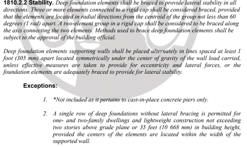

1) I did a helical pile job in a high seismic, crap soils environment earlier this year and it very nearly drove me mad.
2) In many regions, these things can be ridiculously slender. Mine were 1.5" square. Seriously... the decimal point is in the right spot.
3) Per the blurb shown below, in some situations the code allows your to ignore the eccentricity. To make a go of it, you do have to bring your piles a lot closer to being in line with your wall load though.
4) As the other guys have intimated, it's very common for the piles to be embedded within a much narrower, wall-ish element that serves as a grade beam. Something in the 8"-12" thickness range perhaps. Going that route saves a concrete pour and reduces the eccentricity. Like you, I've worried about providing adequate tolerances in the grade beam for pile misplacement. Don't. The piling contractors can locate the piles within very tight tolerances.
5) A slick solution for more "commercial" applications is to stagger the piles as mentioned in the blurb below. That way, the piles themselves can form a stiff load path for resolving the eccentricity. Try this on a residential wood frame project, however, and your corpse will likely wind up cast into the foundations some place.
NOTE: the code blurb below in a US thing, not Australian. You may need to source and Antipode here to help you sort out local requirements.

What about the small loads from the slab on grade, which is considered as suspended. Do I transfer the loads from slab to the wall instead?
I was consider there was not much room if I shift the screw pile to the central line of the wall (but dik and Kootk have pointed out, I won't concern anymore). I also have some loads from the slab as shown. Maybe a 300mm edge beam with screw pile located under the wall centrally is a good option.
