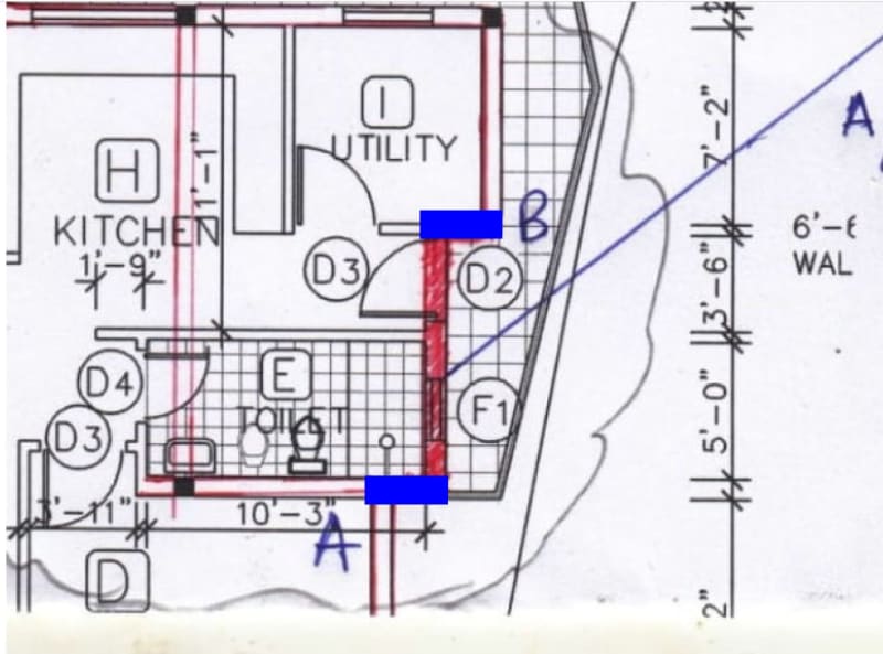

small span RC Zig-Zag beam design
D.Jaya
Sep 11, 2017
29
LK
Dear Structural Engineers
For a proposed 4 storied apartment building, as per the Architects requirement a Zig-Zag RC beam to be designed in between 2 columns at the 1st, 2 nd and 3 rd floor levels(Please refer to the attached typical part plan)
The structure was analyzed for loadings using a commercial software and found that maximum design BM at this particular beam is only 31.83 KNm
1.Is there any approximate method to design a RC Zig-zag beam
2.How do we get the Torsional efffects and incorporated in to the design
URL]
Bad idea... maybe better:
Dear Dik
Thanks for your opinion
Also I will assume that the blue color sections you suggest in your proposal- to be act as corbel members connected to the columns
No, columns... if you have very little line load from the exterior walls, you could look into using a cantilever slab. The column approach is less prone to problems.
Why use a zig-zag beam? The span is only 9'-0". Use a flat slab spanning between columns at each floor level and eliminate the beam.
BA
BART: It depends on the outside wall line load and construction. If small OK... just have to watch out for deflections and creep.
As suggested by BAretired, just consider a flat slab spanning between columns and analyse and design accordingly..
Have done this numerous times.
No idea of a rough/accurate analysis of zig-zag beams..
I would consider two cantilever beams supporting the central beam if beams need to be used(the upper cantilever is without a back-span though).
