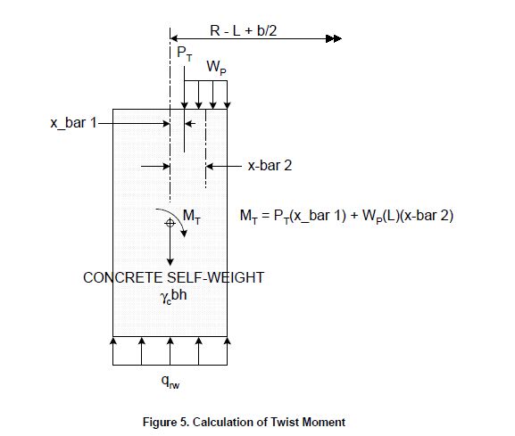

I do not know any specific requirements of ACI, API, PIP... for the distribution of hoop + twisting reinf. In past, i preferred evenly distributed hoop + twisting reinf and follow the minimum spacing rules. I have never designed ring found having large eccentricity.( e.g. for figure A1, DE 1, i would prefer L=20 in. rather than 8 in. for W=30 in footing..)
Refer to Figure 5. ( Calculation of Twist Moment) . The best place for the steel to resist twist moment are the corners of the section (bottom corners..).IMO, it is more reasonable to minimize the twist moment.
I do not know the algorithm of STAAD .. The hoop reinf. should be distributed on outer and inner face .. You may prefer to model the ring beam with shell elements..
