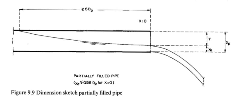

in an horizontal circular channel there is a flow of liquid, it's not full of liquid.
Here is the question:
1 - is there a reduction of level along the pipe?
2 - if yes, how can be estimated?
Did you ask something similar a few hours ago?
1_ Yes otherwise it won't go anywhere assuming the pipe is truly horizontal and there is no gas velocity above the liquid.
2 - Look up open channel flow calculations or search open channel flow on this site
Flow in a pipe like that is a bit odd as it keeps changing cross sectional area as the liquid level goes up and down for the same mass flow rate and hence the velocity of the water keeps changing and changes the hydraulic profile.
Have a look at the attached for the start section which I think is close to what you are looking for, but you really need to deifne a start and end point as otherwise the flow is not steady state.
If the circular channel is level, then there would be a reduction of water level height along the length.
Use Mannings equation to determine the height.

Bimr, the Chezy/Manning's equation [Vavg = (1/n) x R^2/3 x S^1/2] is not directly applicable because the slope of pipe S is 0%, for this reason i'm looking for a deepening, without bother finite difference method. Circular geometry is a complication.

Mannings slope is the slope of the HGL, not the slope of the pipe. When the HGL and invert at the pipe end are not parallel, the hydraulic radius continuously varies. The method for solving is complicated, so I would recommend the use of software to solve.

In attached a simplified scheme, my real system is more complicated because of more feed and more diameter sections.
My goal is estimate the max discharge flow to the river.

gelsi - well it won't be very high if the water doesn't reach the top of the pipe and it's a 100m long....
I think whilst setting the hydraulic slope as the pipe slope isn't super accurate, especially in a circular pipe, it's close enough as the "average" height of liquid would be somewhere close to half full if you started with a nearly full pipe. Try a few different numbers and see if it affects the flow rate.
For a long pipe the velocity is going to be pretty slow and this thing will act more than an open ditch than a pipe. The end is more or less the same as my picture above when you get to the sloped down section if it is really at 45 degrees.
Under the assumption of uniform flow conditions the bottom slope is the same as the slope of the energy grade line and the water surface slope.
