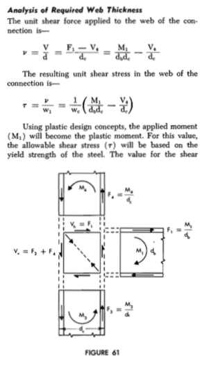

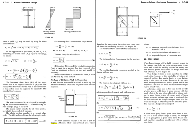

1) Omer Blodgett's book on welded steel construction.
2) AISC's design guide on tapered frame members.
I believe that both references deal with the design of these joints but I don't know that either addresses potential shortcomings.

Thanks for the comments. I understand that diagonal stiffeners on their own are problematic, however, my question was relating to the case where we also have rectilinear stiffeners like the snip below that Kootk pointed me towards. I noticed they do make reference to allowable shear stress (which I'm not sure departs from LRFD design?). I suppose I'll just run through these calcs to check if my thickness is sufficient for my case.

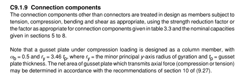

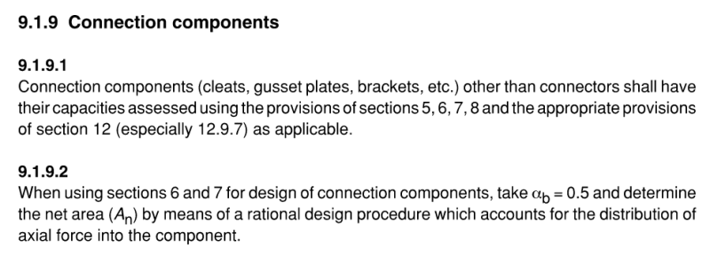

Thanks, that helps a lot. Was wondering whether you had any idea about what to take alpha_b as for steel plates and for that matter, steel rods? NZS3404 doesn't stipulate.
I believe this is intended to actually be covered by the following clauses for "connection components", i.e. alpha_b=0.5
For comparison, the checking of unstiffened webs for buckling utilises an alpha_b of 0.5 with a form factor of 1.0, as it is a similar plate in compression.
Thanks for that - very helpful
