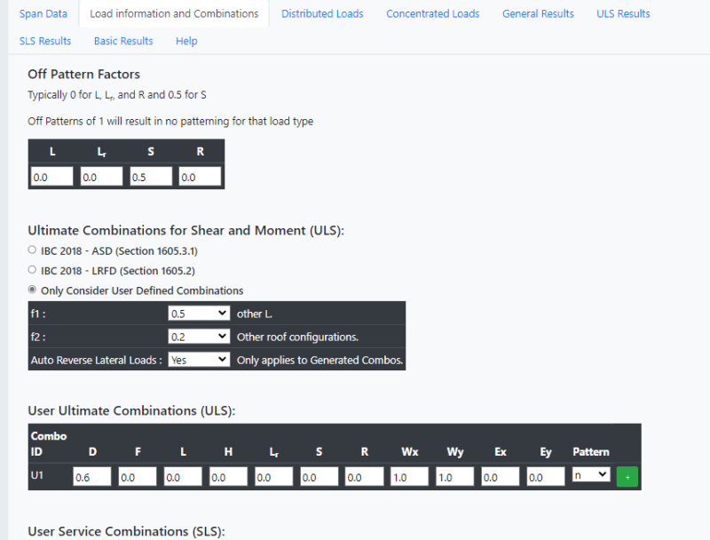

Some of you may have noticed by signature update. I am working on a passion project in the very little spare time that I have with the goal to keep this thing free and open for as long as I can.
I held off on making this post because there is one tool I wanted to have prior to letting the cat out of the bag so to speak, a continuous beam analysis tool.
I am at a point where the tool is in a useable state but still needs a lot of polish, and was wondering if some folks here wouldn't mind testing it out. The tool can be accessed from here, there is no direct link from just navigating the site since this thing isn't complete yet: [link thestructuraltoolbox.com/analysis/simplebeam]Link[/url]
Edit: if you end up getting an error hit your browsers back button.
I've performed a lot of validation checks against the steel manual and some other benchmarks I have and have been getting near exact agreements. I'd ask if you manage to break it which is very likely please drop a bug on the github tracker and I'll get it addressed.

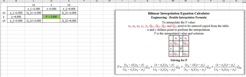

For most spreadsheets that I make for my own use, I like to include the reference material in screen shots. I saw your interpolation routine, and thought I would mention that it is nice to include the formulas, within reason, and in this case the graphical entry "matrix"
Thanks for the feedback dvd, I agree getting references in place is a good idea. I plan to clean some things up and add in the pretty math formulas similar to what shows towards the bottom of the concrete corbel tool.

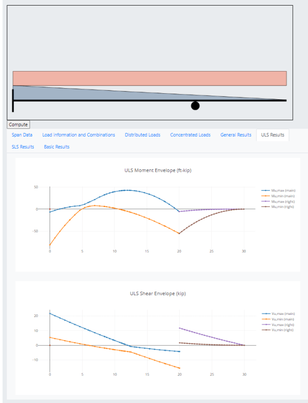

Implemented charting for the distributed load types
Caught a divide by 0 error for distributed loads that had equal end values with opposite sign
General Results Tab will show a very verbose log of the calculation process

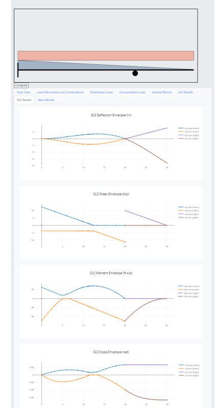

ULS Results shows the ultimate Moment and Shear Envelope plots
SLS Results shows the service Deflection, Shear, Moment, and Slope envelope plots (in that order)
Basic Results will be empty for now
My solution method for the beam solves for the roots of the shear and slope equations so points of absolute max/min for Moments and Deflections are captured in the plots.

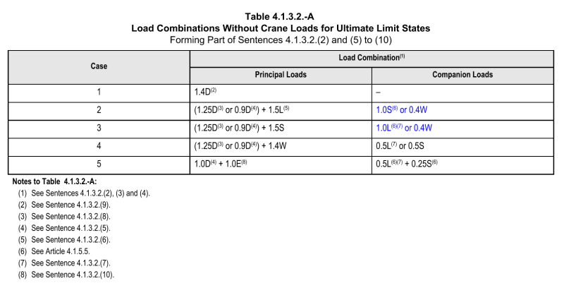

If you have time you could add the load cases for Canada? The BCBC is available publicly, so I pasted the chart below.

I should be able to knock out the option for those load combinations this weekend, as a heads up I do plan to implement a toggle switch to go between imperial and metric units at some undetermined time in the future as that will take a bit more effort so while the combos will get added it will still be limited to imperial units.

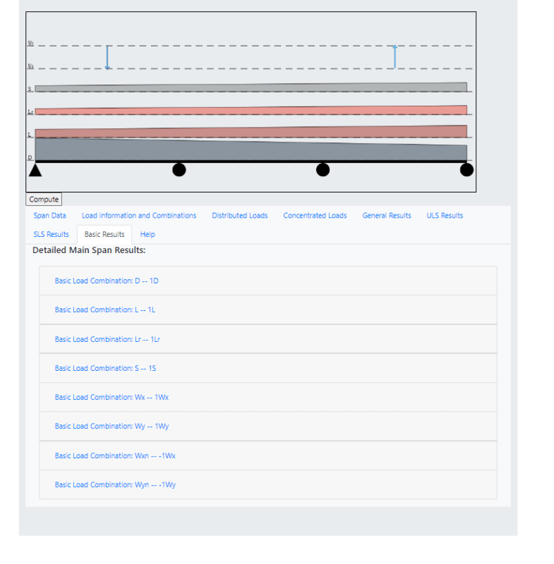

haven't got the load combos you asked for yet, but as a quick compromise I added in the option for user defined ultimate load combinations and a toggle to only consider the user combos:

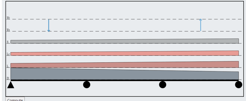

The load charting now also labels the loadings for easier confirmation that they are applied:

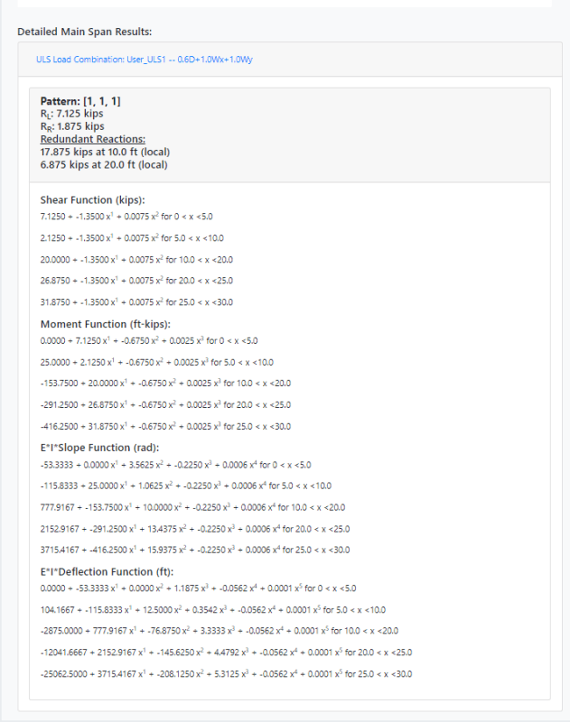

The detailed results for the main span for ULS, SLS, and Basic load combinations are done now as well:

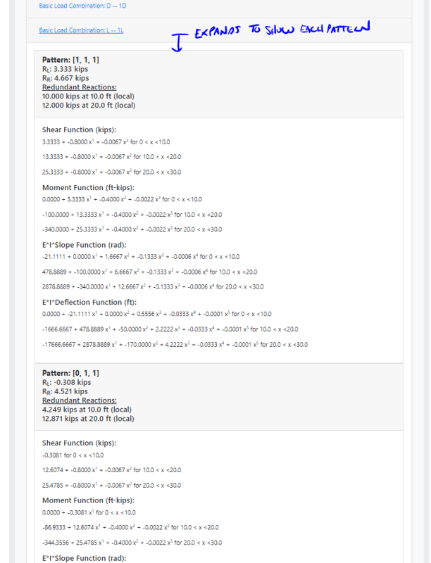

Combination results are in "drawers":
The "drawers" expand to show each of the load pattern results:

The BCBC 2018 Non-Crane combos are now an option. F load types take the place of Live loads due to fluid in tanks from sentence 6 and Lr load types represent storage type loads per sentence 7.
Would love a back check on the combos which are built here (starts on line 345): Link
By default the webtool will do 0.9D factor for all load cases, plan to give you an option to say this isn't applicable to load combos including gravity load only.
