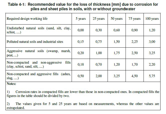

1- The selection of H-pile, Pipe pile or concrete filled steel pipe pile depends choice, availability of material, const. speed. I would prefer steel pipe pile and if necessary , i would increase the wall thick and dia. rather than filling with conc.
Some codes suggests corrosion rate .. For the atmospheric corrosion rate, may be taken as 0,01 mm per year in normal atmospheres and as 0,02 mm per year for marine conditions. I have copy and pasted the relevant table of Eurocode 3 Design of steel structures — Part 5: Piling

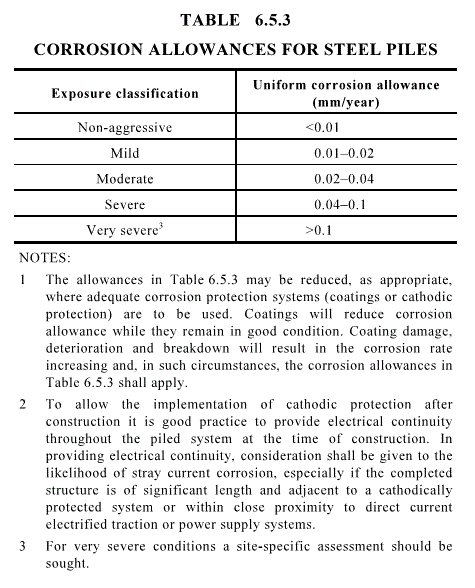

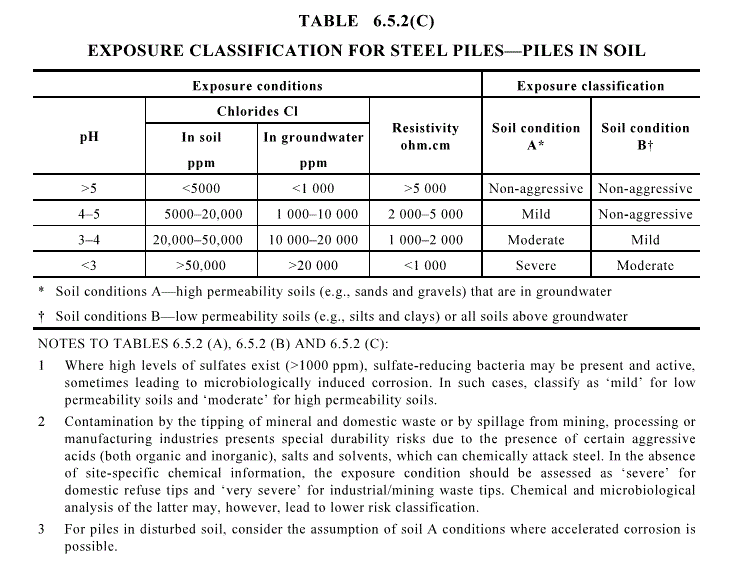

Here are the Australian code guidelines:
