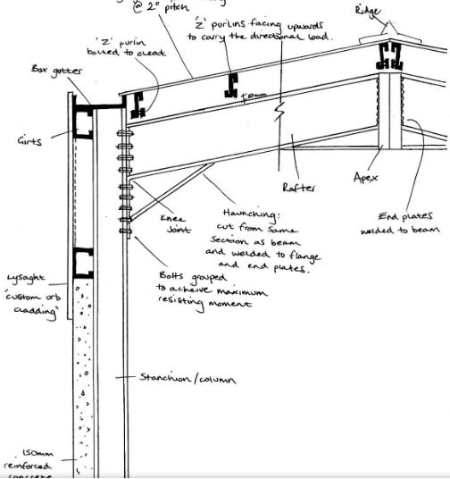

Hi All,
My company has just become involved in a US- based project which requires design of a number of low-rise industrial type buildings. My query is regarding the type of steel frame construction commonly used in the US for this type of building. In the UK we normally use straight hot-rolled beam and column sections for the portal frames, and add sloping tee sections to create haunches to the undersides of the beams at the connections to the columns to get deeper bolt groups etc. I understand that in the US it is quite common to have the whole of the members (both beams and columns) sloping rather than just using locally deepened haunches at the beam supports. Can anyone advise whether both types of construction are commonly used in the US, or is there a preference for one or the other? Thanks, Tom

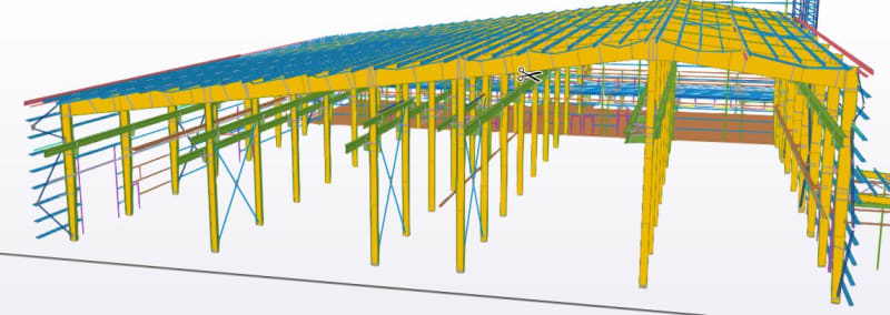

You're correct on a lot of the USA using fully-tapered columns & rafters for industrial buildings, mostly being PEMBs. They're done with a proprietary software that analyzes the tapered members at intervals as small as 12", so it's a lot easier to do the design. You can also follow AISC Design Guide 25, but that can get a little convoluted. There's nothing wrong with using straight hot-rolled members or built-up members, it just depends on what's best for the situation or the most economical. I will note that a lot of the industrial buildings around here use cable/rod tension bracing over portal frames whenever possible for economic reasons and ease of erection, but portal frames are not unheard of when larger openings are required. If you're going to get more into the industrial design aspect, I would recommend looking up the "Metal Building Systems Manual" 2012 or 2018 version by the MBMA. You should be able to find some copies online.
Tom,
I work for one of the companies that does fully tapered members. Like the previous poster stated, they're referred to as PEMBs, which stands for pre-engineered metal buildings. I use a software for some applications that has the ability to design using straight hot rolled sections with just the connections widened but I'm not aware of this ever being done in the US. The software I have is European based.

Thank you all for your responses. It seems that the sloped-beam type of construction is a highly engineered and specialized type of manufacture specific to industrial buildings which is not so much like ordinary hot rolled steel construction. In our case it is required that the building structures are designed as blast-resistant which normally requires the section classifications to be Type 1/plastic as plastic deformation is usually allowed for this. If the sloped beam construction is a type which is intended to be engineered virtually "down to the bone" to get the most efficient steel weights for normal type loading conditions, I am thinking that this type of structure might have relatively slender section elements and probably would not be suitable for a situation where the blast design scenario (requiring the ability of the members to deform plastically) is what governs the design of the sections. Can anyone say if the above is correct, or has anyone come across this type of structure in blast resistant buildings? Thanks again for your assistance.

PEMB structures are always provided as "system built" and aren't something that can be designed by regular consulting engineers. Each company either uses proprietary software or the industry standard Metal Building Software, which is highly customizable and will be different for each company. The reason they can be so different is that the codes aren't written for this type of structure so each company has to do their best to interpret the codes in the way they think makes the most sense and different engineers will come to different conclusions on some matters. It also has to do with each company's manufacturing capabilities. At my previous company, the maximum depth of a member was 60 inches with a 12"x1" flange. At my current company, our maximum depth is 78 inches with a 20"x1.5" flange.
That being said, most of the buildings we do go through the normal consulting engineering process. Consulting engineers with experience working with PEMB structures can do a good job guessing at member depths and foundation reactions to get the foundation and building package to bid. Sometimes they adjust their foundations to the actual reactions, sometimes they do a good enough job that they don't have to, sometimes they probably go conservative on the foundation to avoid any chance of a redesign.

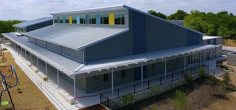

In fact, many PEMB structures are used for schools, churches, government buildings, etc. You just might not recognize them as such.
To address some of the concern I've seen on here that implies that PEMB companies possibly skimp on designing things robustly to obtain a high profit margin, let me discuss. PEMB companies bid to furnish and erect buildings based on architectural drawings, structural drawings and specifications. To do that, we have estimation departments that have to do a quick and dirty design of the building to figure out how much that material will cost. So if the specification and the contract say the floor needs to hold L/360 deflection, an individual engineer doesn't have the ability to decide that their own personal limit is L/600 because the extra material required isn't in the budget.
Because we bid against other manufacturers for work and price is mostly tied to the weight of the buildings, we do try to design with as little material as possible. Throwing in additional extra material as a result of more conservative engineering judgement would result in not winning jobs. This bidding process and the use of as little steel as possible results in small profit margins and with savings passed on to the customer. It's just like with any other sub. If you were doing your own building, you wouldn't want to just get a bid from one HVAC company only to realize that they could have designed a much less expensive system.
So the quality of your PEMB building comes down to the choices of the architect/design team/owner. Specify a building with stringent deflection limits and roof and wall systems you feel good about, get a building that stands up just as well as a conventionally designed steel structure. Allow the drift to be H/60 with a through fastened roof, get a much less expensive building but one that won't be expected to last as long or perform as well.

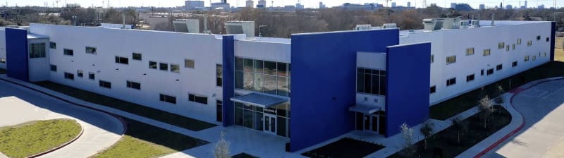

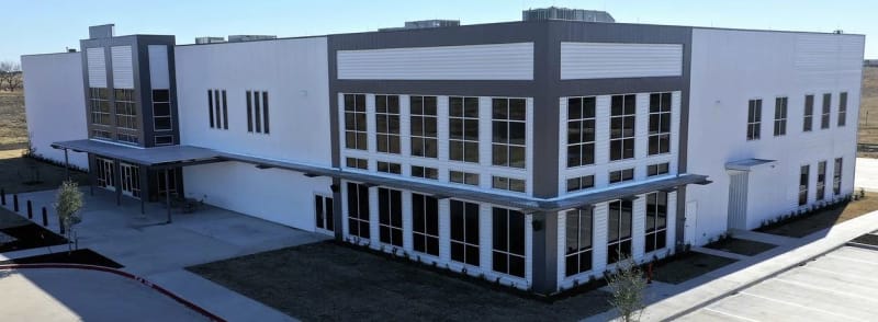

Also, wanted to say those pictures of PEMBs are damn sexy especially for PEMBs! Hats off to you sir

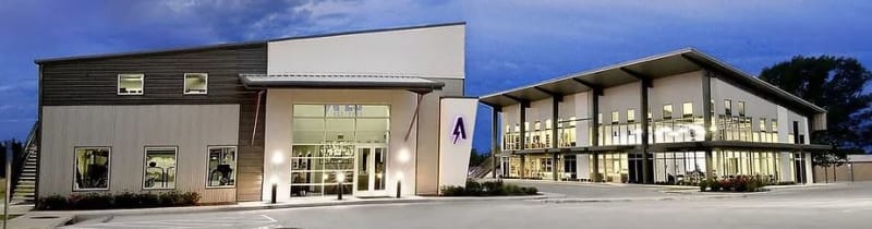

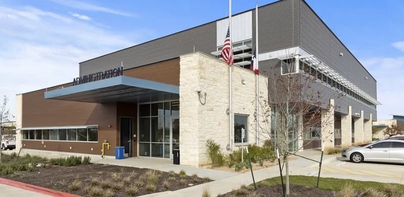

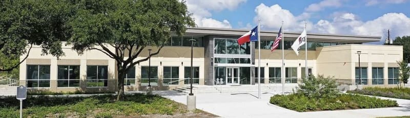

I see a lot of stuff in structural engineering discussions about PEMB structures that sounds to me like-"I bought a Honda Civic but now it won't tow my boat." They can do whatever you want within the limitations of their cost efficiency and code restrictions.
Here's a few more that you might like.
