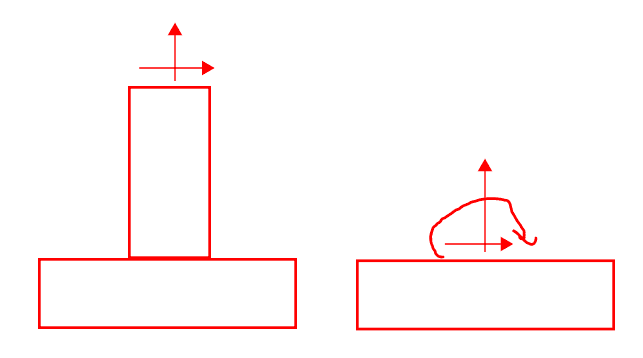

What is causing the destabilizing force on the foundation?
If its a moment an unstable foundation would negate a fixed base assumption. If its shear on top of a concrete pier localized overturning would mean a hinge at the column pier interface. If uplift then that would indicate a global stability problem.

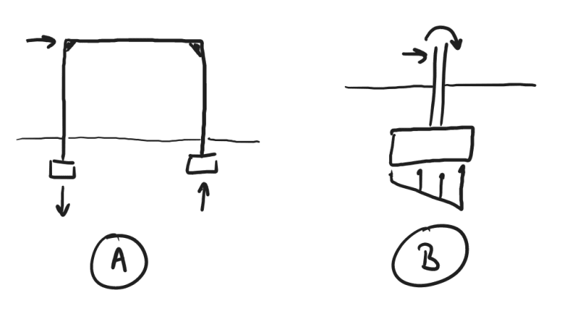

It just occurred to me that there may be a misunderstanding. When you say local overturning are you referring to the uplift that occurs on one column of the moment frame and the compression in the other? If so, you still need to resist it locally. The reason is simple - this is where we are assuming the loads are being resisted. The surrounding frame is likely a series of idealized pin connections. You wont have the necessary continuity to "move" that overturning out to the extremes of the building without some severe distortions. So while your building may not go rolling down the street, the inadequacy of local overturning will compromise the moment frame and, again, cause a lateral instability in the structure.
If you want to test it, run a 3D analysis model but make the reactions under the moment frame columns compression only springs. See what happens.

Which one are we talking about here?
Which one? Both.
There are shear loads at both A and B, but they do not appear to be shown on A.
If bearing capacity is OK, that means instead of failing the soil, as it is apparently strong enough to resist downward rotation, there may not be enough moment resistance and the opposite side will raise upwards and overturning will begin about the point of maximum soil pressure. If you stop it from rotation and translation in the downwards direction, you have not necessarily stopped it from upwards translation. You check overturning stability to ensure that upwards translation is not possible. Even if the soil fails, it is not likely to sink out of sight, but it sure will uplift on the other side, if adequate moment resistance is not provided.

I think phamENG is just trying to get to what situation the OP is concerned about - global overturning/stability of the whole structure, or a local OT at the footing.
Thanks, 1503-44. My question is directed to the OP. Trying to understand his nomenclature, not provide a detailed analysis in my 2 second sketch.
Edit: thanks, winelandv. That's precisely what I was asking.
I get it. But IMO there is already enough confusion and he has got some kind of a problem in understanding why you check overturning anyway. Let's don't make it worse by leaving out loads in our pictures too.
It's more interesting to know if you agree with my explanation. That should explain why both must be checked.

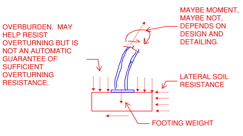

LuisUrgate said:
I can't see a footing below grade be overturned, before that, soil mass mut be movilized and create a condition free to rotate, which involves that soil pressure reach it's capacity. But if soil pressure check is ok and below it's capacity, how could overturning happen?
I would describe the situation like this:
1) The footing being buried in the soil will likely supply some degree of resistance to overturning and uplift.
2) Without some form of numerical evaluation, the footing being buried in the soil is not a guarantee that overturning resistance is sufficient.
3) Your best tool for evaluating the situation will be a free body diagram like the one that I've shown below which considers a hypothetical, net uplift in the supported column.
In summary, [footing buried in soil <> overturning OK]

Thank you all, now I am more confident on this.
phamENG :
I was talking about B. I agree with your explanation, for academic purposes, I will try to study a 3D model a see what happen.
1503-43:
That is a useful point of view. If uplift begins on one side, moment resistance is compromised.
Kootk:
Agree with that. That is the way, lateral soil resistance could help, specially in the presence of pedestals and stiff soils.

Got it. The 3d analysis comment was more about A, but you could still do it by releasing the fixity at the base of the column and see what happens. If it was designed as pinned, then it doesn't really matter.
