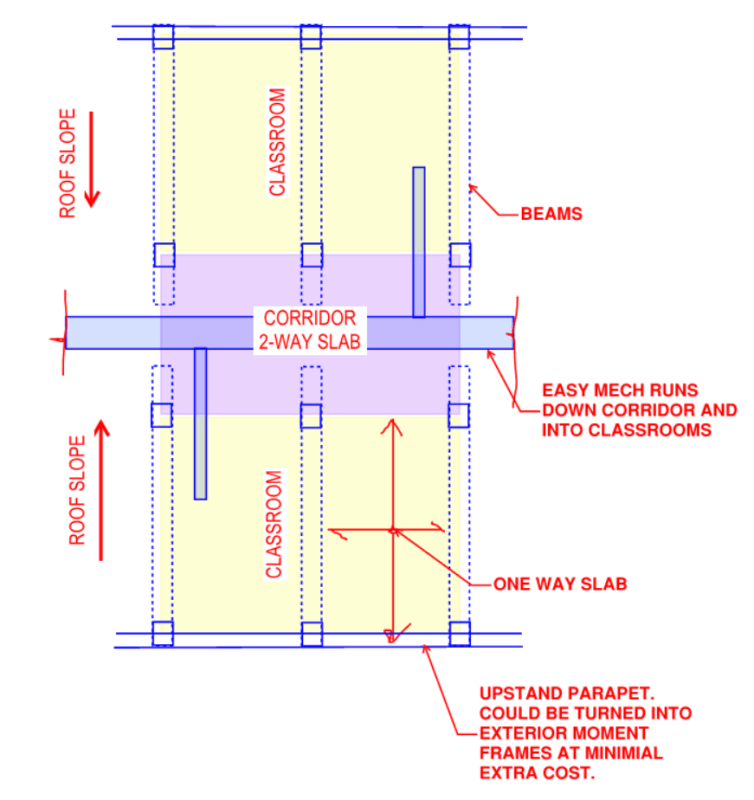

I'll throw my hat in the ring with beam and slab:
1) Lots of future space flexibility.
2) Fairly simple and repetitive formwork.
3) Nice mech run space.
4) Easy roof sloping potentially.
5) I'm thinking mild reinforcing but could be PT easily enough.

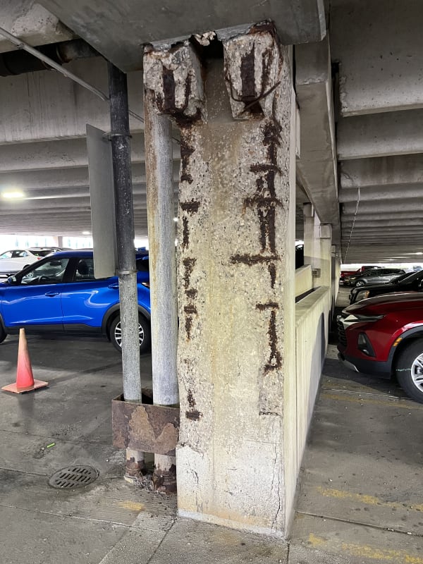

Gratuitous photo of a terrible precast column is below. I took this photo yesterday.
JNLJ said:
This might incur the wrath of KootK.
I'm curious to know though, why do you prefer to deal with masons vs precasters? Baring that atrocious looking column precast quality is usually pretty good in my experience. My guys don't even avail themselves of the cover relaxations that are available.
