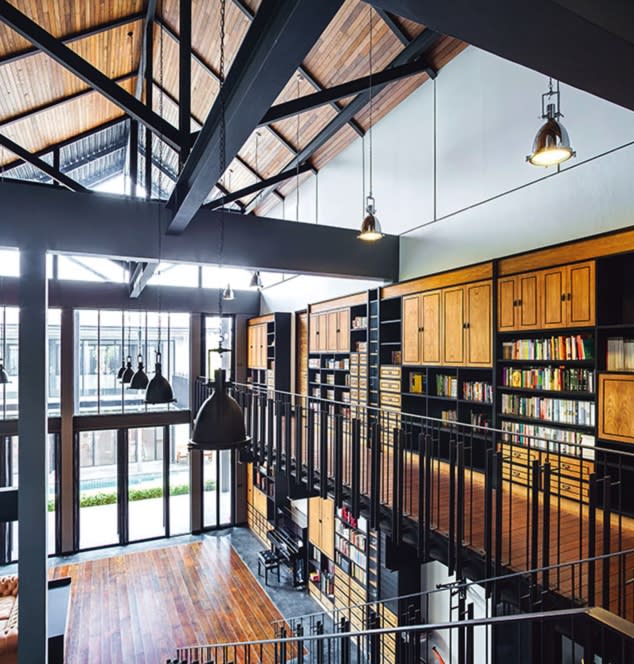

I am in the market for a new home and, being a structural engineer, I’ve considered taking part in the design process of a custom home. My specialty is steel, so naturally I’m interested in designing/building a steel home, if the price is right.
I’m not planning on starting this effort in earnest right away, but it is a passion of mine and I plan on starting to kick around some concepts.
Has anyone here done or thought about something similar? If so, what were your findings?
Does anybody have some thoughts about the affordability, functionality, and durability of steel frame vs. CMU walls with wood trusses? I imagine the main concern would be the cladding material, you would probably still want a precast tilt up facade to attach to the steel superstructure, which might be cost limiting.
Anyways, I think it’s an interesting topic, so let me know what you think.
For design considerations: I am in the Tampa Bay, Florida area.

Being in Florida, in a coastal environment, corrosion is my main concern. My thought was that the superstructure would be enclosed in a weather barrier and not at risk for corrosion. That's also why my main concern is the cladding type, normally I would think corrugated steel would be the cheapest option, but I imagine that would end up just being an expensive corrosion control job every 5-years or so.
I have been in commercial buildings that use the "tin-can" members you are referring to, not a fan! I want to leave the superstructure exposed on the inside, on the walls and the ceiling, I'm really going for the industrial look

Both your pictures are very high end homes. If you are aiming for that level of finish your structure is a rounding error as far as the budget is concerned. I would start with the basic plans and see what makes sense. Form follows function.

I have been convinced that building the entire structure with steel likely isn't going to be an option, but I do want the industrial look. I think I can build with CMU on three walls and then frame the back wall with steel and glass panels.
