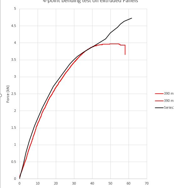

Dear all
I am doing 4 points bending test in Abaqus. After achieving some results, it's aborted.
The results obtained for the simulated part show close agreement
I have tried different mesh sizes, interactions but all in vain

The message is aborted. increment size is less
mesh (10x10), material model (piece wise linear plasticity model) , step type (General static), interactions (Tried all but these results were with general body contact), BCs, loads (displacement control)

Here's what you can try to avoid convergence issues in this case:
- make sure that your model is not underconstrained at any stage of the analysis
- enable automatic stabilization in step settings
- use dynamic implicit quasi-static step type or (as a last resort) dynamic explicit
Also, don't use such extreme values for maximum number of increments and minimum increment size. It won't help and will only unnecessarily increase the time before the analysis is terminated.
Thanks for your reply
I used automatic stabilization in step settings
The job was completed but weird results
Automatic stabilization may sometimes influence the results. To make sure that it's not the case here, compare ALLSD vs ALLIE and/or ALLWK energies and check viscous forces (VF). But you may have to include the damage model to fully represent the behavior observed in experiments.
