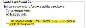

I think the NDS still allows it. I know Wood Works Sizer has an option to recognize inflection point bracing.

Can't find it in the NDS, so disregard that. WoodWorks Sizer does have this option, which I think should be removed:
