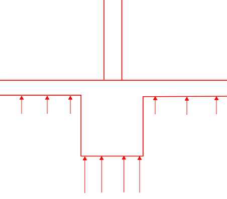

I see the left side detail as a concrete wall, formed and poured to the foundation. You could achieve a similar detail with CMU. It looks like you have a spread footing under that wall (or improperly drawn grade beam?)... I've typically seen these spread footings with a shallower depth and wider width (hence to spread the load and achieve proper soil bearing). Also depends where you're cutting the soil. Some locations won't allow for such a nice vertical cut as you've shown and will require forms.
The right side detail looks like a monolithic slab. For locations that achieve a decent soil bearing capacity, the haunch can be designed (deeper and wider than shown) to take out the vertical load, and you wouldn't require the foundation pour below. This way the GC doesn't have to stage two different pours. To me, the spread footing below the wall & slab defeats the purpose. If you had a concentrated column load that might be a different case. Either way, this slab is continuous and you'll have to give consideration to negative moment over the support (think double layer of top reinforcing).

Can you please brief me about how to design this haunch? In fact, I don't know why haunch is required here, what if it is just a sudden change in slab depth as shown below? As you mentioned it will behave like a continuous slab. So without haunch it is like a typical slab-beam we normally have in suspended structure. So what is the purpose of haunch for both RHS and LHS one?

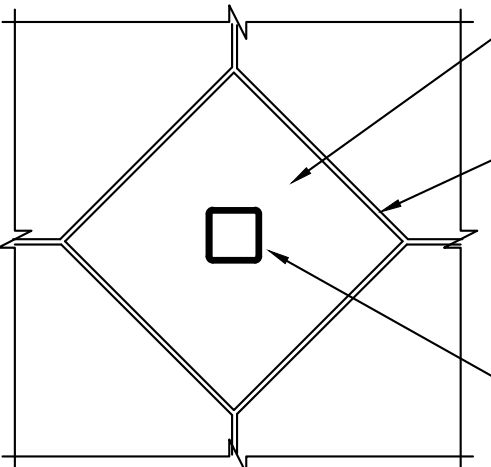

Just one more question. Why isolation joints are required for columns around slab. Why can't we do the right one for column as well?
My belief is that the isolation joints are all about isolating settlement and cracking. If you've got multiple stories supported off of the one column (or wall), then there is likely to be SOME settlement of the foundation. But, the slab isn't really loaded very much, so it may not settle. Heck, it could even move up slightly in wet or freezing weather.
That's why allow for some differential movement between those structural items. In my experience, every time they replace the flooring, they'll look at the slab if the notice any cracks that are not obviously supposed to be there the occupants / owners will get way too excited about it.
