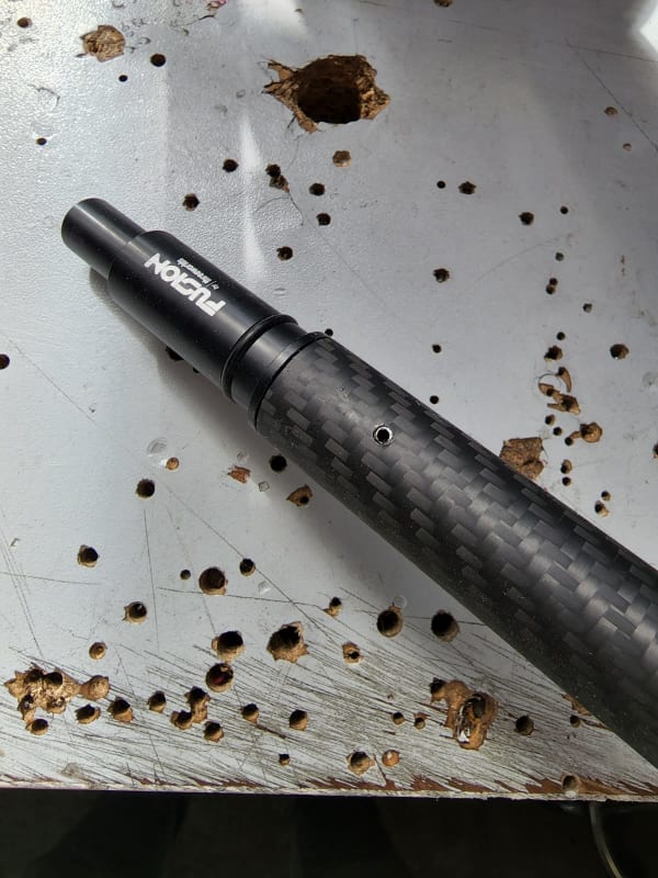

We currently use a 3mm roll pin to secure an aluminium component inside a carbon fibre tube.
We drill a 3mm hole through the two parts and use a hammer with a decent force to insert the roll pin.
We have reports from customers of the roll pins working their way out of the two parts somehow.
The final product is a 1.5mt pole that is spinning when used and forces are applied to the centre of the pole with weights on the ends.
This is entirely baffling which is why I am here to see if anyone could explain why/how this could happen.
The two parts have very tight tolerance and we also use Araldite 2015 to glue in place prior to pinning.
Any ideas how this happens?
Images attached.
Thanks!
Pin worked out on parts and through the EPDM grip.

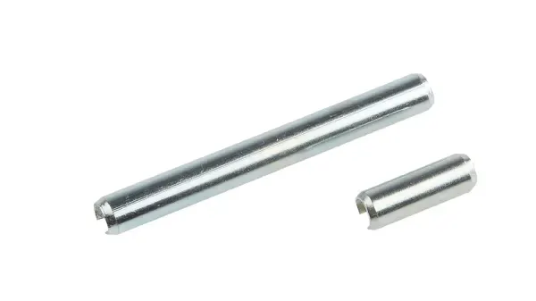

Roll pins are typically tapered on the ends so they can be installed, so I expect it's just using one end as a wedge and as soon as it starts in one direction it keeps going. In addition, being roll pins, they can be compressed by the applied load and it seems like this application is to just keep working it back and forth. As it compresses it isn't completely round and leaves a tiny gap that allows a tiny movement. If there's the slightest lack of perfection in the contact that will bias the movement.

This image shows the actual part with pin inserted.
The roll pin is like this. Tiny bevel on one end only for ours.

Imbalance/gyroscopic couples in the torches at the ends causes a writhing moment in the shaft which compresses the split in the roll pin and lets it walk out on the taper.

If you're sticking with a split roll pin I'd suggest a bit better installation method. A press would likely avoid the damage seen in the photo, as would using a 3-punch installation sequence; roll pin holder punch, flat brass punch, roll pin set punch.
These pins are one time use as well. They'll have a higher tendency to walk out if they've been driven out and reinserted.
If your only machine op is the drill then you’ll end up with bores varying significantly in both size and roundness. Quite often 2-flute drills make 3-lobed bores, which won’t give much friction against a round roll pin so they’re going to walk out. Standard practice for roll pins is to ream to final size bc of it. With concentric bores like shown, the outers should be clearance bores so the inners can retain the pin regardless of relative motion between parts.
