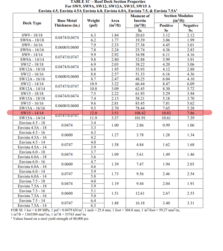

I second Roukkia with Epic Metals Wideck. They claim spans up to 58ft with deck profiles up to 18" deep. I've never spec'd it but we had a rep come to our office once. It does make for a really clean looking roof system from the inside. And apparently good acoustic performance. I'd be interested in what sort of diaph shear capacity you can get out of that.
dold, did you see what the epic metal 58ft span deck weighs? The deep deck is 4-8lb/sqft and seems to be single span only for long spans.
Yup Jay... I'd just make sure I had a copy of the eMail I sent, cautioning them... that would be it. If nothing more than, "This confirms our conversation of 'such and such' where I outlined..." [pipe]
@Brad805
The max span deck is even heavier - ~12psf.
Their IAPMO report (IAPMO 0226) doesn't give diaph shear values directly. Looks like they want you to calculate it yourself based on connector strength but doesn't seem to address the actual capacity of the deck spanning 58ft to your LFRS (panel buckling, etc)... Not sure I like that too much.
