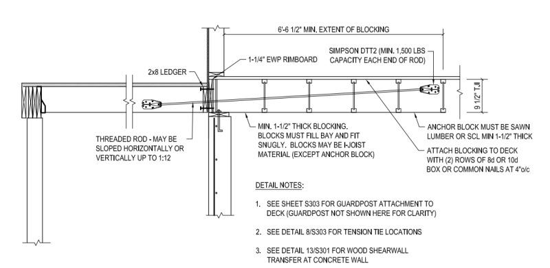

The interior framing runs perpendicular to the deck joists. Here is my detail.
Nice, that's solves the cantilevered diaphragm chord issue in my opinion.
