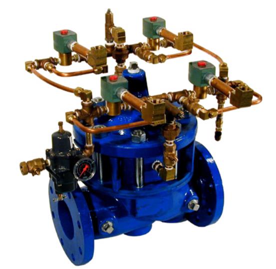

I have a cooling system as seen below that runs water/ethylene glycol mix to cool 13 zones via solenoids.
The pump charges a manifold that the zones draw from. Since temp controllers run the valves none can be open or most of them can be open. All of them are never open though perhaps half could be at once.
I want to spec a valve to bypass when needed to try and keep the supply pressure constant thru the loops while also avoiding dead-heading the pump. I have no idea what the correct term for this particular valve would be or where I should look for one. Given the details I've provided can I get some direction on what and where I should get one, preferably at the usual suspects.

Cla-Val is a very well known brand for self-contained hydraulic actuated water valves and have such for backpressure control. I have used them mostly in such service.
Normally I don't like running min flow valves like this on pressure control, but your rather small pumps have a quite drastic curve so in this case all you need is a back pressure valve set at as high a pressure as you can figure the pump is good for. Personally I would be looking at 30% of rated flow, so probably a bit higher than the operating range shown there, but also at least 10% below the dead head pressure.
There are many self contained / pilot operated valves, but Cla valve are a good one.
The other option is a fixed orifice sized for maybe 10-15% of flow with max differential pressure at close to dead head pressure, but then it operates all the time and you need to include this in the rated flow.
Very cheap and simple but has downsides.

danschwind; Thanks for the names but that has proven fairly useless. Their websites are bloated un useful crap and leave me expecting to find a valve after hours and hours only to find they cost $3k and have a month lead time.
I'm just looking for something I can get a McMaster-Carr or Grainger or Ebay or ? not a week of phone-tag with moneysentatives.
Isn't there some kind of pressure control valve with a plumbed outlet that I can route back to the tank? Set it for 18psi and call it a day?
Currently there is just a bypass valve they "leave open some". What a waste!
Snickster; I'm just seeing valves that are larger than the pump, flange mounted electronic controlled ones at Cla-Val.

Can you cobble up a Cla part number in the area I'm working because I see only things like:
As for duty point or flow there is nothing but a manual bypass valve as mentioned, that's why I'm trying come up with something that can add a trace of control to this thing.
