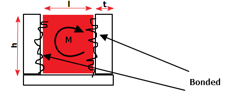

Hello, a problem I'll try to conceptualize best I can:
Let's say I have a rigid solid square section that is bonded on both sides of the flanges at both ends by a c-channel of length width W, flange thickness t, gap (and square dim) l and flange height h (see below illustration).
A moment M is applied to the square tube and equal stress is developed in both c-channel flanges. What is the proper way to evaluate the stress in these flanges.
[ol 1]
[li]Evaluate each flange separately (4 total) and assume only 1/4M goes thru each c-channel flange, however the section modulus is based on the individual flange (poor).[/li]
[li]Evaluate each c-channel as a whole. Assuming just the flanges take the load and not the base (conservative) the moment will be 1/2M for each, however the section modulus will be much higher. This will obvs depend on the separating distance l (example below uses 10), if evaluating it this way the 2x moment will be dwarfed by the additional area being further away from the centroid fairly quickly.[/li]
[/ol]
What's the correct way to evaluate the bending stress in the c-channels, or have I totally missed the mark?

The rigid square section is bonded to the inside face of the flanges (as mentioned in OP). Illustration below to make that clearer.

The weakest part will be the bonding between the channel and the square, so I would look at the shear strength of the bond between the square and the channel.

Yeah, I will look at the bonding separately (different issue :P), trying to localize and focus on the flange(s) of the c-channel currently and how to show the stress in these, I'm thinking it’s either scenario 1 or 2 as I mentioned in the OP, just need some convincing.

Thanks for the update, well the way I see it is if the bonding fails then the square section will twist and contact the channel flanges however they will have different moments on the flanges because as the square twists assume clockwise, then the square will hit toward the top of the flange on the channel at the right hand side and the bottom side of the left hand flange, so moment on each side if you treat the flanges like a cantilever will have loads at different points.
Assuming the bonding doesn't fail (not trying to focus on the bonding, assume square section is one with the channels), the square section will try to bend both the flanges, do you evaluate those flanges separately or combined as per items #1 and #2 in OP? Or by some other method

Either way the flanges on each side will be loaded at different points see sketch, I guess if the channel is a drawn section you would analyse it as one s but in my opinion I would check the shear strength of the bond. If the bond fails is the result considered a failure of the component?

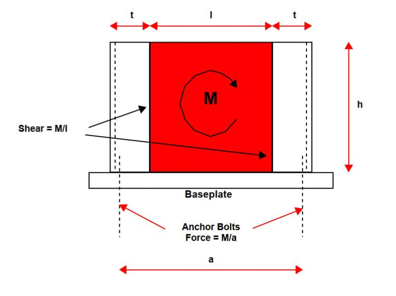

The simplest would be to simply add a baseplate under each end of the square section, but if the square section is an HSS, it has rounded corners, which require special welding treatment.
Using channels, I suggest using the sketch below. That way you can develop the full section of the channel, rather than relying on the flanges alone.

Both the base and the cross section. Could use a vertical plate in lieu of each channel.

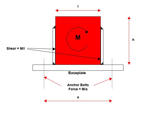

A simpler detail is illustrated below. Each plate carries a tension or compression of M/l:

@BAretired - I was asking the OP rather than you, sorry. Could have been clearer. How the OP has the end arrangement constrained in turn has some bearing on the stress experienced within it.
I think the stress in the plate is a tad more complex than evenly distributed across the length and/or width - I'd probably guess the same for the bond for that matter. I'd expect the edge closer to the centre of span to be more highly stressed than the opposite end depending on the various stiffness of the components and the bond etc. I'm also assuming this is 'bonded' not welded as @BA has shown.
