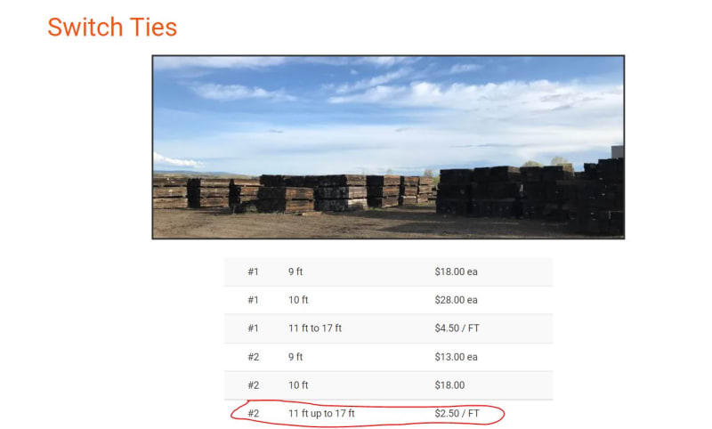

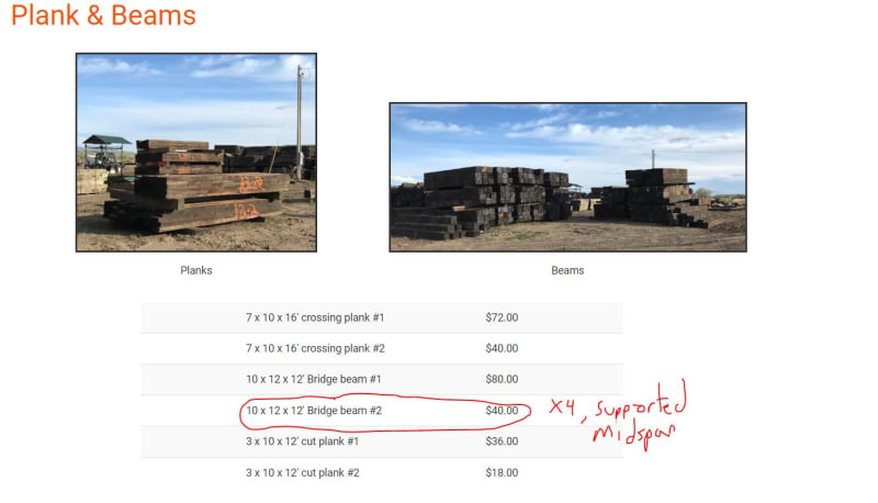

Another option may be to use Railroad ties or bridge beams. There is a contractor near me that sells them for a reasonable price; perhaps there is something similar near you.
I've bought their stuff before. The #1s look really really nice, and the #2s pretty good (they could be hidden on your bridge)
I looked into it but many railroad ties are soaked with creosote. This may leach into the pond and affect the fish in the pond so I don't want to risk that. I have used railroad ties for planting borders last a long time and very heavy duty as long as it's not bordering edible veggies.
