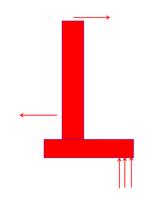

I have a situation where in order to take out the lateral thrust onto the S.O.G and not design huge footings for that moment (Horiz. Load* Height from top of footing to U/S of base plate), attached the snip below for reference...... If I place my hair pins at the bottom of my col. and connect the column to S.O.G, can I not worry about the Lateral thrust?, its a PEB portal frame. Thank you! for responses
At the other end there will be another column in the same line and it will to0 have the same situation where the anchor plate is at top and S.O.G is 8 feet below
Hairpins don't have a lot of capacity typically, usually less than 10 kips for large bays. Where phamENG is going here is you have to develop the hairpins into the slab and if the columns are spaced too closely you get less capacity as the zones intersect. You would also need a reinforced slab that you are developing into that can transfer across the building, typically you would have construction joints that would need continuous rebar across to continue the load path.
Now to your problem - what kind of force do you have on this pedestal? You mention portal frame, is this the main frame lines or an actual portal (moment) frame for lateral stability, typically along the exterior of the building? Because you are not able to create a fixed base connection at the top of the pedestal, the way I see this is you have a couple developing to form a cantilever pedestal and therefore will have a horizontal reaction at the hairpins and a horizontal reaction at the foundation below that you will need to design sliding for. With what you have I would believe a moment foundation would probably provide the best design based on the given information, espeically being that the pedestal is 8' tall and the eccentricity from hairpins to footing is approximately 2' therefore you are looking at horizontal reactions of about 4x the actual loading put into the top of pedestal to handle the moment.

The horizontal load max is 14.6Kips
Its an actual portal frame for lateral stability typical pre-eng build.
Foundation designed it for sliding for the horizontal reaction, worked out.
Designed the pedestal for that lever arm distance of 8 feet (from top of pedestal to the S.O.G where the pin is, the horiz. load)
The danger item is, actually the footing is going to be another 9 feet below cuz of the frost depth, so its not at 2 feet down from the slab, that's why I worry about doing it as a moment footing cuz the bearing pressure was crazy.
- (9 ft + footing ht ) would be around 11 ft.. seems too high ..suggest you to check the frost depth ..
- If the grade wall extends to the top of footing, ( literally 9 ft depth ) , the total sliding resistance of the footing ( sliding+ at rest soil thrust ) should overcome the max. horizontal load 14.6Kips..
- With this geometry , you should not need hair pins at SOG ..

Draw yourself a free body diagram of the horizontal forces. You have the equivalent of prying action, magnifying the hairpin forces something like 14.6 x 12’ / 4’. Close to 50 kips. AND you need to design the footing to take the resulting “kick” of 50 - 14.6 = 35.4 kips. That’s ugly.
Better to design the footing for moment.

The independent foundation approach may be best for a myriad of reasons but, at the same time, I wonder if a model like this might be exploited to advantage. It was good enough for high-rise shear wall foundations pre-FEM. One would have to design things to allow the tie rods to yield.

That's an interesting model, however, what is resisting the upward pressure created by the force couple (I get it, it's the self weight of the footing and soil above... but something still seems a bit off to me while I'm typing this)?? I am just not sure how well it would work out, and designing the footing for the moment will let me sleep better at night.
SteelPE said:
...what is resisting the upward pressure created by the force couple...
There isn't any, that's the beauty of it.
You don't need to count any of the dead loads. Granted, to the extent that you choose to, it just makes the solution more economical. Here you'd get the footing and soil, as you mentioned, as well as:
1) The reliable dead load on the column and;
2) At least 20 kip worth of knee wall weight.
SteelPE said:
...and designing the footing for the moment will let me sleep better at night.
Sure. I would actually consider this approach to be a version of designing the footing for moment.
Keeping everything in the kern and producing a design with no footing uplift certainly does allow one to sleep well at night. In my markets however, it does not allow one to produce competitive designs.
Koot's got the right detail... uplifting force is resisted by structure weight and weight of soil... done it often.
