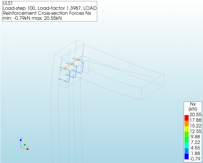

I revised the model to include the 300x4400 slab with the dowels as suggested by Greenalleycat. The force in the primary corbel ties do increase.

@Brad805, are you the dowels you've modelled between the wall and the corbel, or the corbel and the slab?
I just did some hand calcs as a rough estimate and I get higher loads, though I have had to make a number of guesses that could throw me out
I also wouldn't be so sure about the wall being OK
I did some rough calcs and it could be on the line - though again, I had to take a number of guesses

A concern that I have is the secondary moment that's induced from the dowels cast into the slab
Presumably for construction sequencing the corbel will be built, dowels cast out of the top, then the slab poured with the starters in it
This gives a fixed end capacity
As the soil is added the slab will be trying to deform and rotate at the ends but the dowels will restrain that, helped by the pile of dirt on top
This then passes a secondary moment into the wall in addition to the primary moment from the eccentricity of the reaction force from the wall
Rotation in the wall will lessen this effect, so it depends on how much this rotation relaxes the moment vs the moment capacity of the wall
