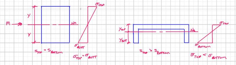

We typically use the the weaker of the section modulus for minor axis bending of a channel (Syy -X vs Syy +X), but is that overly conservative? Can someone point me to a good reference to back this up?

Remember from mechanics of materials that for a linear elastic material and from Hooke's Law --> σ = M*y / I
where y is the distance measured from the elastic neutral axis to the location of interest.
When y is the maximum distance to the cross-sections extreme fiber then y / I = 1 / S or I / y = S, where S is defined as the elastic section modulus. When a shape is symmetric the distance from the elastic neutral axis to either extreme fiber is the same and S,top = S,bottom, and by extension σ,top = σ,bottom. When the cross-section is not symmetric as is the case with a channel in weak axis bending S,top ≠ S,bottom, and σ,top ≠ σ,bottom. If the channel is oriented such that the flanges face down then S,top > S,bottom and σ,top < σ,bottom meaning that σ,bottom would be the controlling stress for yield.

As Celt83 mentioned, the lower Sy will give you the stress at the tip of the flanges and the higher Sy will give you the stress at the web. The stress will be higher at the tip of the flanges since it has a lower Sy and σ = M/S. (The Dimension and Properties tables in Part 1 of the Steel Construction Manual only list the lower Sy value.)
For the Yielding check, the maximum stress anywhere in the shape is what is critical since that is where yielding will initiate, so you use the lower Sy.
For the Flange Local Buckling check, the maximum stress in the flange will be at the toe of the flange, which can be determined using the lower Sy.
