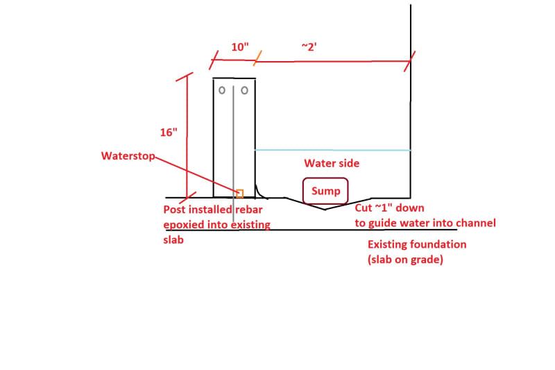

In theory the bund shouldn’t be that difficult, I’ll put a few dowels into the existing slab and put a water stop in the bund wall. The wall won’t need to be very high, perhaps only 16” or so. I’m thinking of doing something like this :
First question is whether I should put in two water stops?
Second questions is if it’s possible to do something like this using CMU block instead of forming up a RC wall? I’m guessing a CMU wall wouldn’t work with the waterstop but would appreciate guidance.

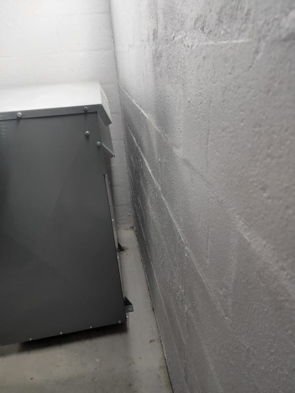

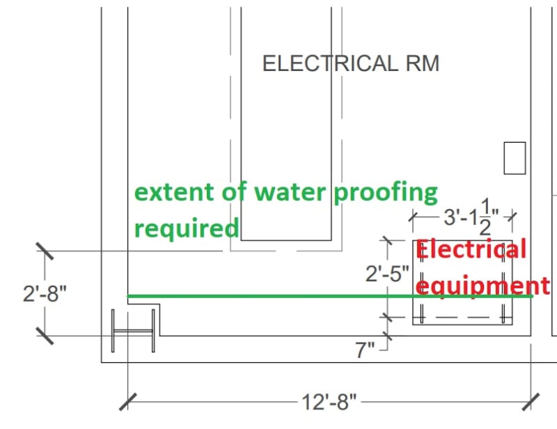

Now, bund wall aside, there is another issue where there is a large piece of electrical equipment that is only about 5” to 7" away from the wall in a specific location where the bund wall would’ve needed to be. This would be extremely expensive to move as it is hooked up to some hard-wired electrical lines. How can I waterproof this location when I only have ~5” of clearance? I assume whatever is done here would need to tie into the 2’ wide new bund wall? Any advice would be greatly appreciated.
I’ve included a plan for context below :
Any guidance on this approach or if you think there is a better one, please let me know.

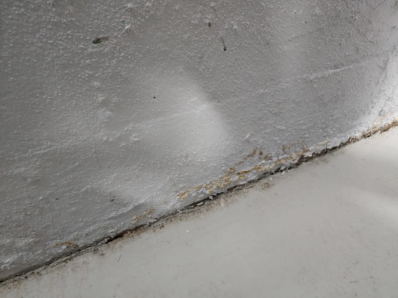

Some additional photos for context :

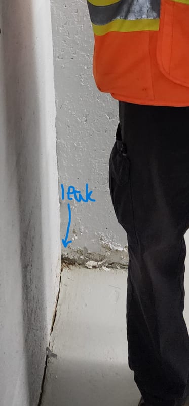

Will you post some pictures around the steel column?

Not the best photo but this is the corner column where the water was shown to be leaking out, there may be other locations but I feel this is the main one. The column is a steel beam encased in concrete.
Perhaps both waterproofing the concrete and collection pit may work. Waterproofing as the first line of attack and if this fails the bund wall would still protect the expensive electrical equipment.

- The last picture implies the leak is at corner and along the wall -slab CJ rather than concrete wall . The foundation system probably spread footings and bottom slab on grade ..
- The CJ can be repaired with XYPEX ..however , the concern is the pore water pressure may build up and uplift od the slab..
I will suggest you, make sure that the WL rise will not uplift the slab for mortar repair from the inside and if necessary, excavate from exterior along the wall and provide drainage .

Yes, the water is coming out of the corner and most likely at the CJ between the wall and slab (this is evident as there is a separation shown between the elements and I've seen a video of water leaking out of the corner).

Cam you raise the electrical box vertically and put the bund wall underneath it?
