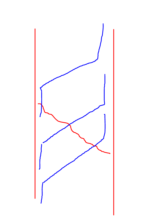

I've seen folks use z-bars, as shown below, to shear reinforce basement walls. It does tend to get pretty busy if you're having to reinforce large swaths of the wall however.

CAR said:
I don't think that z-bars will work, since they're directional.
That's easy enough to solve. Just make the bend angles 90 degrees. Or a 90/135 candycane if you prefer.

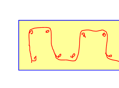

Or something like this viewed from the top if the bending would be feasible. This could just as easily be WWM if your prefer.
