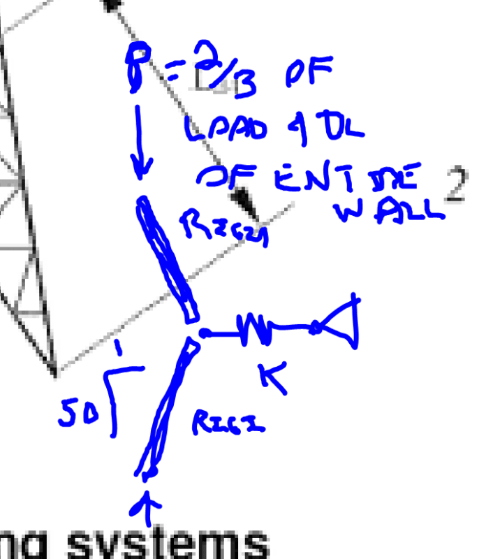

Here's a proposed method. It's imperfect but will have to do until something better comes along:
1) Model the upper and lower walls as rigid posts, hinged at mid-height and 2% out of plumb.
2) Apply 2/3 of the total wall weight and total load applied to the wall at the top of the model.
3) Work out the spring stiffness required for this to be stable.
4) Work out a beam stiff enough to serve as the equivalent spring to #3. Assume the beam to be laterally loaded at midspan.
This should at least serve as a decent barometer of the situation. If you meet this check in spades, sleep easy. If not, make the beam stiffer or find a way to refine the analysis.
One thing that complicates this check would be long term lateral creep in the girt. I'd be conservative in your estimates of that here.

The methodology you propose sounds reasonable- do you have a reference for the 2/3 load and the 2% out of plumb? Will also be careful about creep/shrinkage etc.
I spent quite a bit of time Friday looking for something about this topic in the US masonry codes & references I have and was pretty surprised to come up empty handed.
Bisbeee_Structural said:
...do you have a reference for the 2/3 load and the 2% out of plumb?
The 2% was homage to what we typically do for other materials such as steel. And I believe that this represents the origin of the "2% rule". I imagine that you've actually seen this wall and can, therefore, gage whether this is more appropriately a 2% situation or a 10% situation. I don't know that the final answer is even all that sensitive to this estimate. It's mostly just a perturbation to get the instability fun rolling.
I've got nothing for the 2/3 business other than "it makes sense to me". If you imagine each foot of wall as a vertical strip truly independent of its neighbors, then my method seems about right for the strip at the center of the girt. For the strips at the ends of the girt, I would expect those to produce no stability demand at all in the beam unless the beam supports themselves are flexible. Using 2/3, I'm basically ignoring the demand originating from the 1/6th strips of wall at the ends and overestimating the demand from the load in the middle 2/3. I feel that this puts things somewhere between "appropriately conservative" and "ridiculously conservative". I recommend that you give this some noodling to ensure that it speaks to your own intuition. When it comes to risking the lives of civilians, you probably shouldn't be just relying on the advice of some internet nutball.
