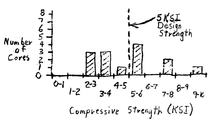

Make use of the data you have... concrete compressive strength variation is all over the map:
1) Half of the tests (7 out of 14) show compressive strength below design, several significantly low.

"Reading the tea leaves" tells me this bridge was "poorly" constructed to start with (60 years ago).
Before proceeding will full deck replacement, I would recommend the Owner to at least do a preliminary evaluation of the substructure.
Good chance similar "shoddy" construction happened there, too.
