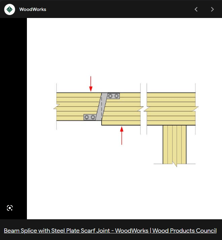

I was going to apply steel plates at each (side) face of the beam with lag screws for the transverse shear.
I don't love that particular connection type for this. If possible, it's often advisable to set these things up such that the shear is delivered to each member in bearing, similar to the detail below.

I agree with KootK on the preferred detail type.
If I use that detail, can I still apply moment plates top and bottom. Keep in mind, I've got these splices at places with very low moments. But who knows exactly how they'll lift this beam in place and there may be some moment developed under self weight during placement.

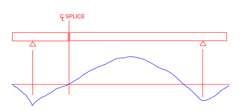

Can that be done along a propped cantilever beam? Even though I'm putting the splice at a point of zero moment I would still provide moment plates for continuity. If I did what you suggested, wouldn't that make the beam unstable?
See beam with moment diagram:
With your latest sketch in mind, I believe that your splice will have to be a moment connection in addition to a shear connection. That, and you'll need to consider which partial load case produces the maximum flexural demand at the splice. This will be come a much more difficult problem given that moment connection in conventional wood construction are typically thought to be quite dubious owing to connection slop / slip and the fact that many of the best moment connections tend to spread out the fasteners in a way that restrains cross member shrinkage and induces cracking.

I'm thinking of using a Simpson HCA hinge connector and dapping the top and bottom of the beam to create a flush mount. This would handle shear. Then I'd run moment plates over the top/bottom and create moment continuity.
Wouldn't touch that connection with a barge pole. Can't the glulam fabricator make the beam in one piece?
I'm with BA. No, thank you. That beam does not have a reliable point of zero moment anywhere in it's span. Why is the beam not being installed as a single piece?
Still working through it. I would include design for a minimum level moment but not the maximum moment the beam experiences.
Due to the roof configuration, the rafters need to be spliced due to available lengths. Good thing is, the utilization of the beam is very low. The beam is oversized due to exposure and architectural demands.
