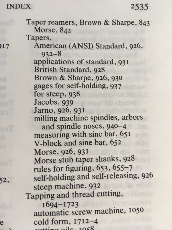

There are numerous taper standards for several different purposes. You did not share what this particular application is.
ALL engineers that have anything to do with machinery of any kind should have at least one actual real printed book on their shelf - Machinery's Handbook. From the index:
Before calculators were common 225/32 is how you would spec a taper.
