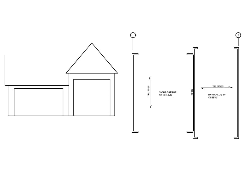

As an example of what I'm talking about is this sketch of a detached garage I worked on. When I look at this structure I see a lot of the lateral load going into that center beam where the plate height jumps from 10' to 14'. I proposed that the beam should be steel and form a steel moment frame with W-shape columns at each end of the beam. When my boss sees this structure he has the lateral load ending up in wall lines 1 and 2. I don't understand how that is realistic, and I don't understand how there could even be a calculation to show how the load "jumps" from the lower diaphragm to the higher one, and vice versa.
The load is going where the stiff lines of resistance are. You may be correct that the diaphragm shear has to pass through the beam to make up the offset, but the load doesn't just flow into the beam because its there. Those two little wall segments attached to the center beam are very flexible compared to the walls on GL 1 and 2.
But your still correct the load doesn't just magically jump from the upper level to lower level, I would ensure you can get shear transfer boundary nailing from both the upper and lower diaphragm into the beam.
TBH it sounds like you could use some different mentorship. Hand-wavy attention to detail isn't a good look on an engineer imho.
How much detailing are you being asked to do? My firm would certainly require a detail for shear transfer at that offset.
We didn't have any shear transfer details for this. My thought is that the bottom of the beam is at the 10' plate height. The higher trusses bear on a 4' tall wall that sits on top of the beam. The 4' wall and the beam are sheathed on the left side. There should be a truss at the lower garage that rests right up against the length of the beam. The top chord of that truss should be nailed wherever it crosses the studs for the 4' wall. The bottom chord should be nailed periodically into the beam. The lower diaphragm should have edge nailing from the sheathing into the top chord of this truss. That's what I was thinking, is that what your detail would show or did you mean something different? This garage has been built already so I'm wondering what they actually did.
I would need to see the geometry but it sounds like your thinking something similar to me.
Edge nailing needed from the upper diaphragm and the lower diaphragm on the same beam. Perhaps a 'ledger' type nailer on the side of the beam, something to finish the sheathing into that is also connected to the beam with the edge nails.
That detail is routine for this type of house.

How is the garage stabilised in the perpendicular direction?
I'd be doing the same thing your boss does. Treat it as 2 three-sided buildings in the front to back direction and don't sharpen your pencil too much. That is how most houses end up working and it keeps you from having to worry about things like this.

In your garage example, I think there are ways to do the detailing so that middle line doesn't get a ton of shear. Though I think it begs for a strong wall or something on either side of that middle line. Making sure you got something like drift limiter suggested to get force transfer from both diaphragm heights into that center beam. Personally, I think that's just easier than trying to pull all the load out to the far walls.
