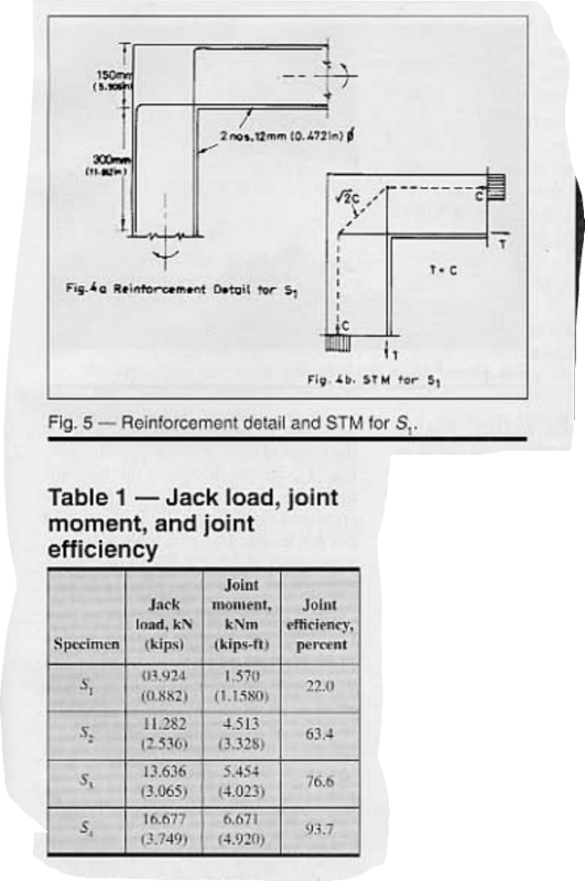

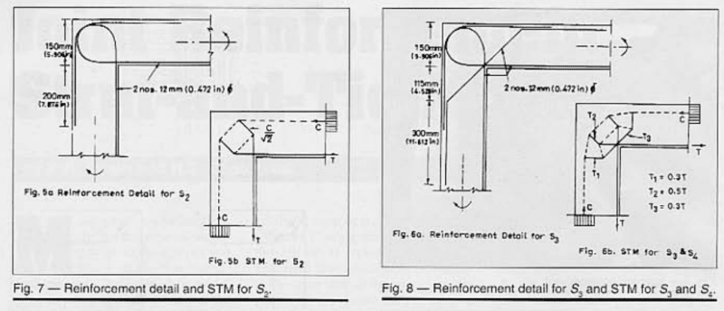

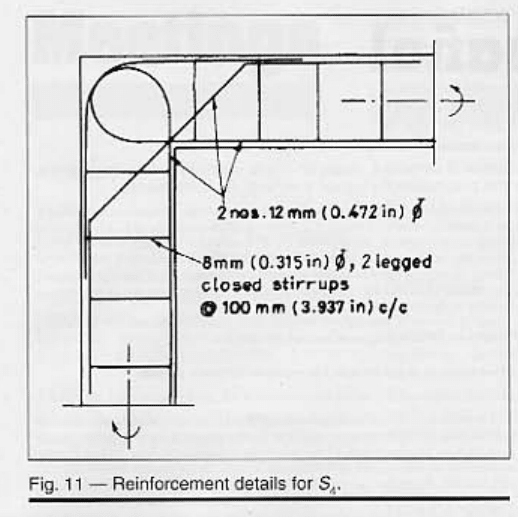

The principles that inform the detailing of the moment/retaining wall condition are discussed in detail here: Link.
gusmurr said:
In terms of anchorage...

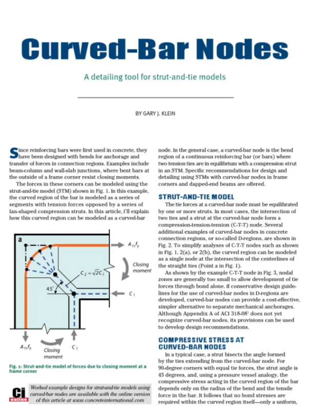

It's not actually an anchorage problem in my opinion. For moment resisting connections, what we're really dealing with is a bar bend designed to transfer rebar tension around a corner. The best STM reference for this that I know of is shown below.
gusmurr said:
The Australian standard states that 50% of the development of the reinforcement must extend beyond the nodal zone. This means that the face of the node can only begin where the reinforcement bend occurs (i.e. at the straight portion).
I believe that this represents one of the most important facets of the design of these joints. The phenomenon that you mention is precisely why these joints tend to be weaker than incoming sectional analyses would predict: because the effective flexural depth across the joint is compromised as you've observed.
This makes sense to me, so I am wondering if it is best to keep the concrete struts somewhat internal rather than at the very face of the member?
Obviously this would result in the B regions of the members being slightly over-designed, but the joint itself having the required capacity.
