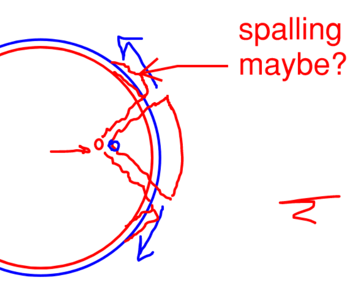

This is the picture that pops into my mind when I contemplate this. A large radius of curvature on the hoop reinforcement works against your here. Never mind the spalling business. Drifted into thinking rebar instead of wrap... That said, the CFRP equivalent of that would be the CFRP peeling off of the pier.
The benefit of CFRP wraps, and why it has been used for seismic strengthening of columns, is that it contains the concrete preventing spalling. CFRP has very high tensile strength which is what is needed to resist outward internal pressure. CFRP wraps may not help much with column bending. But definitely talk to a specialty firm who should do both the design and installation.

I don't feel that logic is applicable to a situation like this, however, where the breakout is a localized thing caused by a transverse stress rather than a longitudinal one. You're handle suggests that you may be more adept at this kind of thing than I, however, so I'd welcome the opportunity to be re-educated.
Maybe the wrap works because of its extremely high modulus of elasticity. It just doesn't like to stretch and does a better job of confining than circular ties.

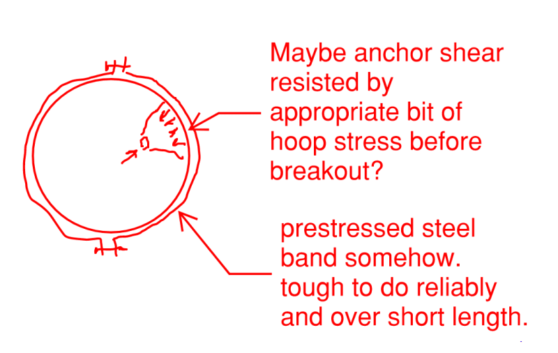

I have two ideas for alternate fixes but, frankly, I don't love either:
1) Drill dowels into the side of the pier to be the Widanto cross ties after a fashion. Based on your situation, however, I suspect that the dowels would have to be painfully long. they might also have to be anchored at the perimeter of the pier with curved anchor plates or something.
2) The wacky concept shown below which may suffer from all manner of practicality issues. The difference between this and the CFRP is that you're inducing the confinement action ahead of time rather than passively waiting for the load to induce them.
Is ductility a concern in the connection? Even if you can get over KootK's issues, you'll have a brittle failure mechanism controlling your structure to foundation connection.
KootK, your idea might not be entirely wacky. A few months ago we were investigating a similar idea with some prestressing strand running through a dogbone and tensioned with a monostrand jack.
Our application was temporary, so you might have to encase the whole thing in concrete for durability. But a PT contractor should be able to manage it pretty easily.

As long as we're indulging creativity / insanity, another proposal:
1) Weld up a ring of steel larger than the pier. Maybe toss some studs on it for sport.
2) Add a strain gauge to the exterior side of the ring.
3) Place the ring over the pier concentrically.
4) Fill the annular void between the ring and the pier with a grout deliberately chosen to be expansive.
5) Let the grout expansion prestress the steel ring.
6) Check the strain gauge to verify the circumferential hoop stress.
Obviously, one would won't to do some basic creep / expansion calcs along the way to make sure this all isn't a horrendous waste of time.
Disclosure: I've never done this nor heard of anyone doing this. I've no idea whether or not reasonable grout expansion rates could induce meaningful hoop stress in this way. I'm just and ideas guy here... somebody else needs to execute.

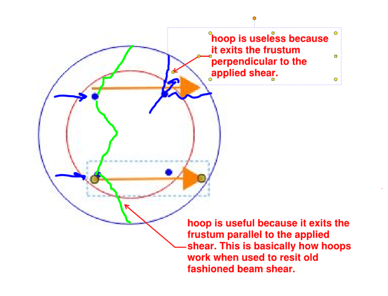

Whether handled via Widanto or handled via App D, I think all of that boils down to the model show below, taken from my previous sketch.
The issue du jour is the angle that the hoops make relative to the shear load when they exit the breakout frustum. If the hoops are relatively orthogonal the the shear load, then they'll be almost useless other than the 15% bump that I mentioned previously. If this angle is relatively parallel to the shear load, then the hoops become tension ties / supplemental reinforcing in the valuable sense. Because of this the angle of the applied shear load the assumptions made about whether the shear load goes to the front or the back are hugely influential. I'll elaborate in my next post.
This is my elaboration on the influence of front loading vs back loading, based on the exit angle of the hoop from the failure frustum.
With regard to the front loading vs back loading, these are my thoughts on the matter:
1) Per ACI, if you're going to assume an equal distribution of load to the front and rear an anchors, that needs to be justified somehow. Weld washers, non-over sided holes, bolt clamping friction... something.
2) If you've got the justification for [#1], then I could support an equal distribution of load to the front and rear anchors. I could not support the justification of loading only the rear anchors unless we're assuming that the concrete failure frustum in front of the forward anchors is allowed to materialize which has been discussed. For that, my concerns would be:
a) As you mentioned, anchor rod buckling in compression over an effective length that is your standoff plus the depth of the shear frustum breakout, whatever that is.
b) Corrosion of the anchor rod if a vector for water intrusion has been created and the effectiveness of passivation has been compromised.
c) Because of your stand off, the anchors will be bent into an S-shape prior to the shear frustum breakout developing. Once the shear frustum breakout forms, the anchors will want to snap back to straight which will exacerbate any spalling tendency.
If the strategy for the CRFP here will be simply to keep the failure frustum from popping off of the pier wholesale, then perhaps a cheaper strategy would be to simply pour a new, reinforced concrete ring around the top of the pier. Maybe that causes problems with aesthetics or frost heave, I couldn't say.

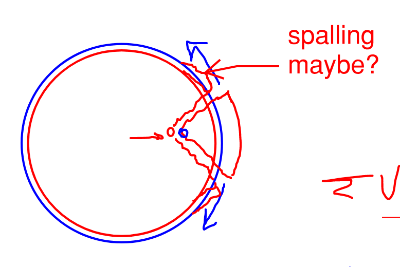

dauwerda said:
...where there is a strut formed between the anchor and the vertical bars...
In truth, and even in the Widanto paper, I would say that there are not really struts being formed between the anchor and the vertical bars. I think that it's more accurate to view the vertical bars simply as distribution members that smooth out the delivery of load from weaker concrete struts to stronger steel bars at the connection points. Much like "padstones" in the UK parlance but operating in reverse.
With the GFRP wrap scheme, you really have no need of the vertical bars as distribution elements because the wrap will be vertically continuous rather than discretized as rebar hoops would be. So I would say that the GFRP solution would be agnostic to the presence of the vertical bars.
