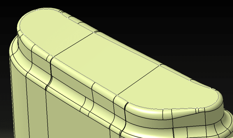

I want to make a fillet which its value follows a curve
for this case, the result should be a variable radius, with its value in each point, the value from distance, from edge to curve.
Something like CREO does:

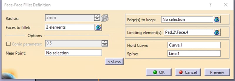

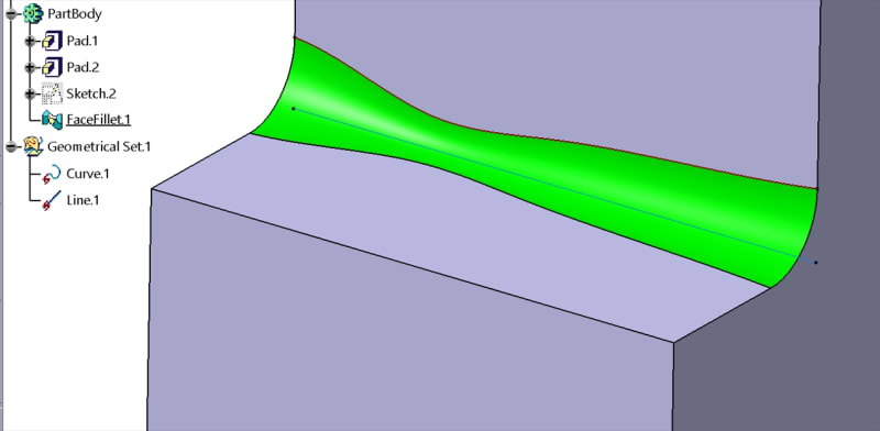

Try the Face-Face Fillet.
Choose two surfaces (one from each side of the hard line)
Choose your curve as the "Hold Curve"
and choose a spine.
Your existing curve might work as the spine as well.
The hold curve will give you a symmetrical variable fillet, i.e. both faces will follow the (one) hold curve. If you want to specify a curve for each face, try the styling fillet (which is capable of two hold curves, one for each face)

I'd like to see the result Tiago
