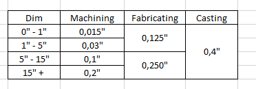

On an old rotor assembly drawing we received, there's a table with general tolerances ('unless otherwise specified'). Now in this tolerance table there are 3 columns: Machining, fabricating, casting.
I only know certain ISO-norms, such as ISO 2678-mK. I'm unfamiliar with the 'machining, fabricating, casting' tolerance table on a drawing.
What does the 'fabricating' column refer to? Is it to the assembly of parts? Does it refer to the fabrication of raw material? Something else?

Can't post a picture, best I can do is show a resemblance of the table:
The values in above table are irrelevant/made up. But this is a resemblance of the general tolerances table on the drawing.
I'm looking for what the 'fabricating' column refers to.

I'd guess based on tolerance value the fabrication column is an intermediate machining step where the blunt cast part will be premachined for later processing. This is where datum features are established usually to align the part later on in the fixtures.

One of our suppliers interpreted the 'fabricating' general tolerances as tolerance for the final assembly. And now the assembly doesn't fit due to the large tolerances specified in the 'fabricating' column.

"Fabrication" = sheet metal bending or other forming operations.

I'd add welding in the fabrication definition.

Seems like fabricating is just about anything but casting and machining.
