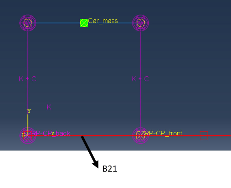

Thank you for your support. I decided to use the 3D beam model because *release command works with no bug. In this 3D space, How would you simply model the half-car model as shown in the picture, providing a surface-to-surface interaction between the beam and contact point? That model works well in 2D. I don't know how to simulate this car model that will move over the 3D beam.
Something like a rigid beam perpendicular to that bridge model should work. General contact will handle this interaction.
