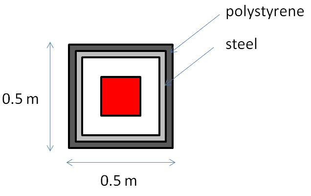

Here is sketch of box.
Box is 0.5 m in length, width and height. Apparatus will be attached to front of box but on little posts so not making directing contact.
I will assume all heat generated by apparatus will be carried away by apparatus cooling tubes. Only heat entering box is conducted through walls of box or from direct sunlight on box. Thickness of polystyrene can be made thicker, but steel probably 1.6 mm.

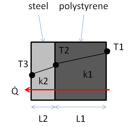

I zoom in on small section of box walls.
I assume inside temperature T3 is 25 °C. I assume outside temperature T1 is 40 °. Is this okay assumption, that surfaces are same temperatures as surrounding air?
I then use equation for steady rate heat transfer through multilayer wall:
Qdot = (T1 - T3) / Rtotal
Rtotal = L1/k1A + L2/k2A
I careful to make sure areas (A) are the proper sides or tops of box. This tells me amount of heat getting through walls of box because of internal and outside temperature difference.

No. For example a black surfaces exposed to afternoon sun "on a 25°C day" can easily reach 70°C
I don't know what temperature a reflective surface might reach, but I'd guess it could be in the 40 to 50°C range in even high North latitudes.
The side facing the sun will get hotter, even with reflective surface - maybe as high as 50C. Thermal input from peak solar is normally about 1kW/m2. With reflective maybe 600-700W?
The other sides will get simple air convection heating - much lower heat input, but if the box is freely suspended by say a bunch of wires then yeas the other sides could assume to be at ambient air temp.
The steel conductivity is so much higher than Polystyrene ( about 1,200 times) that it's almost not worth bothering about. Its only impact is that the inner surface of the box will be a constant temp as the steel will move any hot spots or sides.
Also as your inner box surface area is quite a bit smaller than the outer box surface area your simple flat plate analysis calculation formula doesn't work. Quite sure there's a formula somewhere, but don't know what it is....
But for a box this small nothing is going to be accurate and this really looks like a bit of a waste of time. With say 75mm / 3" of polystyrene insulation, your heat input is going to be really pretty small. How much heat are you taking out from the mysterious apparatus. Assuming this is not minute, then just add 10% for external heat. Or make the insulation 150mm and it will cease to be an issue with only 15C differential temperature.

Based on 75mm polystyrene insulation with a 15 C temp difference I get a heat input of about 10W.
So my 10% wasn't too far off.
Yes very close to my answer as well.
