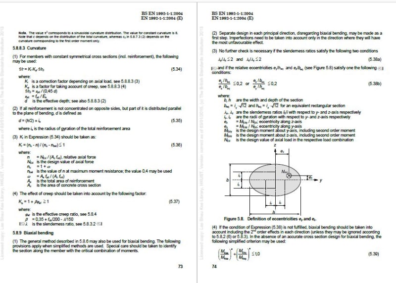

If we assume Medy= 150 kN-m and Medx= 100 kN-m ( Assuming these are design moments at orthogonal directions )
Medy/Medx= 150 /100 kN-m = 1.5 that is; > 0.2 and < 5.0 ; you can not ignore, Biaxial check is required.
You can use the formula (5.39) suggested at EC-2 ,( BRESLER'S FORMULA)
I have copy and pasted the relevant page of the code. ( This is law resource and free )

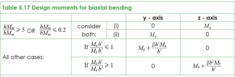

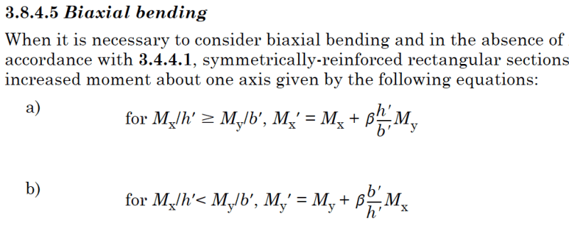

Further, as I see, the equations you provided alone can't be used, after the bi-axial check you provided, we need to use the BS 8110 equations to determine the moments. I didn't notice anything similar in Eurocode2. So I had to use BS8110 equations below. Hope these are ok to use.

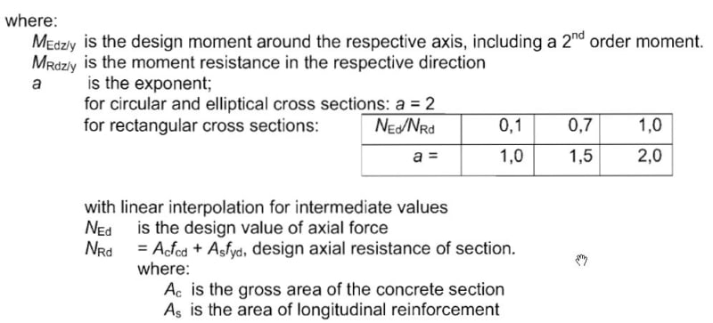

In the case of biaxial bending, Equation 5.39 at the bottom of page 74 tells you how to combine the moments, if you are not going to do a detailed analysis:

What I previously planned to do
1. Combine moments using: BS8110
2. Calculate the area of r/f and other section to that moment and requirements: (Eurocode)
3. Check the resistance vs effects the equation you have supplied, to check if the design is safe (Eurocode)
Why doesn't that create a safe design, I'm trying to learn.
I have seen almost all the books out there used the BS8110 to combine moments.
And even the manual published by the institute of the structural engineers (United Kingdom) shows that the BS8110 equations can be used.

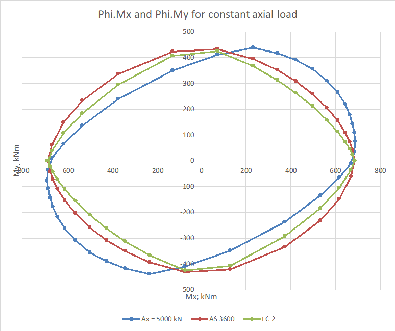

I don't know if I have the source code anymore, but about 25 or 30 years back I wrote a biaxial bending program for concrete rectangular columns, and it is actually quite involved. Far more complicated than uniaxial bending.
Regarding the need to check the resultant capacity of the section in the direction of the resultant applied moment, even though it isn't required by the code, see the graphs below from the link given in my first post:
The blue line is the capacity of the section in the direction of the applied resultant moment. The red and green lines are the capacities to the Australian and Eurocode formulas respectively.
Section with very high axial load:
Non-rectangular section:

Whatever method you use to derive the initial moment, you have to check that the section is strong enough for the combined moment.
Using Eurocode, you can either use Equation 5.39, or you can check the section capacity under the resultant moment, analysing the section as asymmetric.
If you use the BS8110 formula as the starting point, you still have to do the same checks to make sure your final section is OK.

Further to my previous post, it's actually quite easy to derive an equation for the minimum resistance moment, similar to the BS8110 one.
For applied moment Me and moment resistance Mr, if Me/Mr is equal about the two axes then Equation 5.39 reduces to:
2(Me/Mr)^a <= 1.0
So for minimum Mr: (Me/Mr)^a = 0.5
Me/Mr = 0.5^(1/a)
Mr = Me/(0.5^(1/a))
In the graph below I have plotted 1/(0.5^(1/a}} with 1 + Beta from BS8110, and an equivalent factor from the Australian code (AS 3600), for a range of axial loads:
The higher factors are more conservative, but in practice any of them would be OK to use, as long as you check the resulting section against Equation 5.39 (if using Eurocode 2), or against a detailed biaxial analysis.
