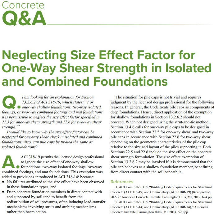

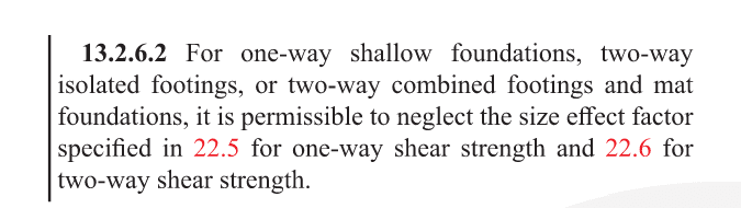

@celt83 I reached out to ACI to ask if the size effect factor can be neglected in pile caps and their response was no it can not but in simple one-way and two-spread footings that bear on soil you can indeed neglect the factor so spread footings shouldn't be affected too much but the new equations for shear without shear reinforcement still decrease the capacity. ACI just published the following excerpt in the October 2023 edition of Concrete International. I was told by ACI that this question (and questions about one way shear in ACI 318-19) are on the rise.
From the quick numbers I’ve run on things the size effect factor isn’t causing most of the reduction instead I’m seeing the rho^1/3 term providing the most significant reduction so spread foundations experience about a 40-60% reduction in shear capacity even though the size effect factor is 1 for these elements. This was for slabs, walls, foundations so elements that wouldn’t normally be exceptionally thick.
With a rho = 0.002, that essentially results in a 1/8 reduction meaning, for elements where it applies, before the size effect you are starting at 50% less capacity than 318-14 for elements where 0.002 would provide As,min.
@Celt83, You are indeed correct after I looked into it a bit more. While the size effect factor does reduce capacity, the new rho term has a much larger effect. In looking at the numbers from the situation in my first post if I were to see the size effect factor to 1, I still have roughly a 40% decrease in capacity just from the new equation utilizing rho^1/3.
