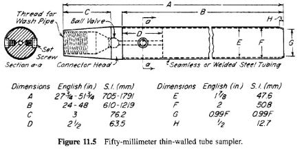

We typically used 51 mm tubes for our projects in clays in Ontario. Question? - are you using "real" thin walled shelby tubes (meeting all the dimensional specifications as per ASTM D1587) or thin walled steel tubes?
from Terzaghi Peck and Mesri

I have been doing some research between the drilling supply companies. what they sell are 2-in OD shelby tubes.
Do you know who sells "real" thin walled shelby tubes in USA?
I think I used to order them from Boart Longyear. Humboldt Manufacturing may also have them.
I'm sure that I also saw primarily 2" OD tubes being used in Alberta, Canada
