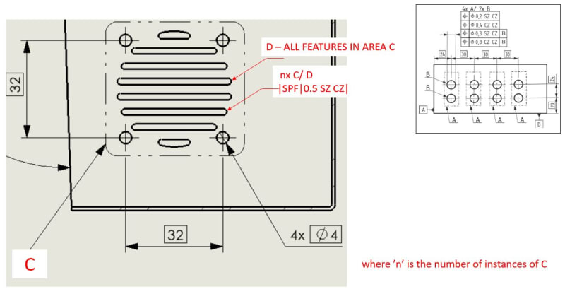

I would like to constrain profiles on particular portions of a folded sheet metal part simultaneously. Is the approach in the images below reasonable when using ISO GPS? Several similar areas are defined throughout the drawing and the same flag note is called out for them. A 3D file is provided with the drawing to specify the dimensions that aren't shown. The intent of this approach is to have tighter tolerances on faces of the sheet metal while relaxing the tolerances around bends. Is there a better way to indicate these requirements?
Ryan6338,
Your proposal makes sense to me with one or two caveats:
1. Since the secondary datum B-B specified in the general profile callout is defined at MMR (i.e., the datum system does not fully immobilize the part; so called datum feature shift is possible) and because of the default independency principle in ISO, I would recommend to you asking yourself if from functional point of view it is OK that the tolerance zones for all the features controlled by the general profile may be evaluated independently during inspection of the workpiece. If it is not, then I would suggest addition of CZ modifier after the tolerance value of 2 in the tolerance indicator to group all the tolerance zones together.
2. Theoretically, the CZ in the profile tolerance in the note and the word "simultaneously" mean the same thing. I think the note could just say: "In addition to the general profile tolerance, |SPF|0.5 CZ| applies to all features within each specified area, but not across separate areas."
In case you want to try to have the same set of requirements specified in a more symbolic way, you could do something like this (it is sort of inspired by Figure 9 in ISO 5458:2018 which I added to my picture for reference):

There would still have to be a note associated with the SZ CZ profile callout stating that the requirement applies in addition to the general profile, otherwise, per the rules of ISO 22081, the general profile would not apply to the considered features.

Thanks for the feedback pmarc. I hadn't considered datum shift in the general tolerance so I will evaluate whether CZ is required there. I like your suggestion of the symbolic representation. Annoyingly I don't think SOLIDWORKS allows multiple indications of CZ and/or SZ in a tolerance frame since they've recently reworked geometric tolerances in drawings. Going the symbolic route I think I'd just stack a profile tolerance on that is the same as the general tolerance rather than putting it in a note.
The reason I used CZ and simultaneously in the note was because I wanted to remove ambiguity as to whether the CZ only applied to each closed profile independently or to all profiles with the area. That said, I think the symbolic method you mentioned resolves any ambiguity issues.

1. SIM REQT is used when multiple tolerance indicators are specified. In the discussed example, there is only one general tolerance indicator, therefore CZ is the tool to use.
2. I did not have to use all around because in my proposal 'D - ALL FEATURES IN AREA C' applies to 36 surfaces and not to 12 features (4 round holes and 8 compound holes).

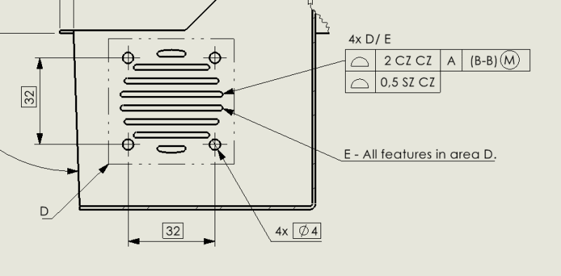

Final result to wrap it up. Had to use tables to enable the use of multiple CZ and SZ callouts, but it looks ok.
Ryan6338,
It looks OK to me.

I am not sure why you are saying the proposed solution is not fully ISO GPS concept. Because I haven't used the all-around symbol? Again, there is nothing wrong with treating all 36 surfaces in the specified area as individual features which are then are grouped by the CZ modifier in the smaller profile tolerance indicator. The note could have as well said 'D - ALL 36 SURFACES IN AREA C' and the '4x A/ B' could have been replaced with '4x A/ 36x B'.
I deliberately stayed away from the all-around because this would make the drawing look much more complex.
As far as MBD goes, I am not sure the note is a problem from CMM consumption point of view. The proper association of objects would have to be done in CAD software anyway. The note is just a human readable information.

Sometimes it is better to take the simplicity route. Especially in the ISO GPS world.
The example from ISO 5458 that I used as reference illustrates pretty simple geometry where there are only two holes within each group, the holes are of the same nominal size and are just single surfaces. That's quite easy to describe with just two labels B and then by applying the rules for multi-level group controls defined in the standard
But the OP case is more complex and we could both easily imagine even more complex scenarios where the conventions used in the standard couldn't be that conveniently applied. This is where a doze of imagination is needed to simplify the drawing that otherwise would be semantically correct but look extremely busy and hard to comprehend.
That's also one of the reasons why I merely suggested to Ryan6338 considering the symbolic way instead of pushing hard for it - I think his original proposal, although utilizing a note, was quite straightforward.

greenimi, I'm not sure the argument is simplicity vs education. I think it's more simplicity vs strict compliance to the drafting standard. If I were to represent the specification in a fully compliant manner, there would be many more symbols which seems to me like it would increase the chance of any one particular symbol being missed. I believe reducing the symbols - as has been done here - increases readability overall and is a worthwhile trade-off from strict compliance to the standard in my particular situation.

I don't think the solution I proposed is noncompliant to ISO GPS standards. There is no need to apply the all-around symbol here. All surfaces within the specified areas may be treated as individual features.
If Ryan6338 wishes, he may replace ALL with 36x in the local note for E and add 36x to the 4x D/E above the stacked profile callouts. This will look even more similar to the example from the standard.

The paragraph does not address the situation we are having here. Here, the profile callouts apply to multiple surfaces of which just some form closed contours. There is no need to explicitly group the surfaces into all-around contours.
