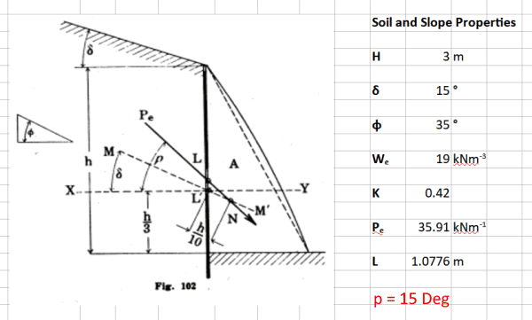

have I correctly interpreted the Krey method?
I get L = 1.000 m for these conditions, not 1.0776.

My choosing δ = 15o is not just some "random" slope. Fifteen degrees is a good practical slope, about 3.7 horizontal : 1 vertical, but I picked that value, δ = ρ, to easily "stress-test" the math in the spreadsheet... and the spread sheet "flunked", it is spitting out garbage.

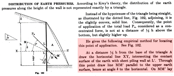

The Krey paper (which I posted on the referenced thread) also say:
which is:
and if that is not enough, I solved the problem the old-fashion way... analog, scaled drawing using pencil & paper, following Krey's (Figure 102) instructions:
When you start at h/3, draw a line angled "down" 15o, measure off h/10, then draw a line angled "up" 15o... surprise... you are right back where you started... L = 1.00 m.
