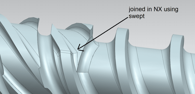

In solidworks i used to connect these helical thread using 3D arc with tangent relation btwn edge and the curve then loft two sections using 3D tangential arc as a guide curve.
I tried the same in NX using swept but i am not getting smooth joint as solidworks and also i am not able to give tangential geometric relation for 3D curve.
Please tell me how you guys would do it in NX, i have shared a STEP file , if possible plz show me how you do it.

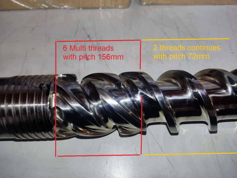

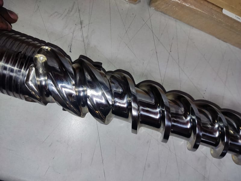

the gap is there because a single thread starts with different pitch after the multi 6 threads completed so in order to join that single thread to one of the 6 multi threads its mandatory to connect them together , and also both thread profile have little different dimensions.
i have tried through curves, through curve mesh , ruled and finally i got it in swept but not smooth joint as i wanted.
you can see the real helical screw down there in images
