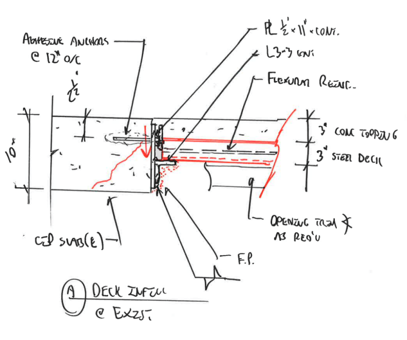

Starter detail to get the juices flowing.
As I wrapped it up, it occurred tome to make the following improvements:
1) Flip the bearing angle.
2) Go with an 8" slab.
3) Replace the top anchors with drilled in rebar that becomes slab top steel at the perimeter for a better bearing anchorage condition.
4) Add some nominal anchors lower into the slab just to hold it all together.
MSL said:
...though I'd use something like a C6 channel or W6 instead of an angle to span the 8'.
I feel that's overkill for what, in my scheme, would just be temp reinforcement for the deck prior to the concrete hardening.
MSL said:
In that case, no shoring is needed.
I meant shoring solely for the purpose of avoiding underside steel deck reinforcement at the opening.
MSL said:
It will be tough to shore, since the existing opening is stacked and it'll require some beams spanning over the opening to support the shoring.
Pish posh... git 'er done. The engineer can't be the only party solving problems here. The "shoring" could even just be steel spanning the opening.

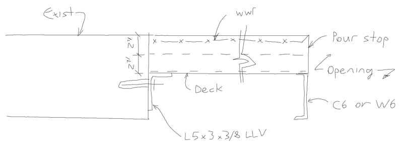

My idea:
Advantages:
-Less dead load
-No rebar
Unfortunately I'm not at my fancy artist tablet so that's the best I could do, and couldn't annotate much. I had an idea for how to connect the channel, but it was excruciating to draw that much, so let's just say that it's a ~1' long channel with a few epoxy anchors.
If a 4'x3' opening, I'd likely use a C6 to span across and distribute the loading a little more uniform and use 1-1/2" deck with a 2-1/2" topping to minimise weight... and connect accordingly.
In my case, I'm not relying on the concrete at all. Only the deck and the steel supports.
