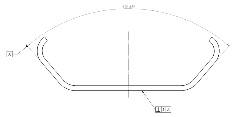

Hi!
I'm trying to dimension and add GD&T to this cross-section

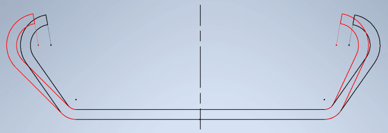

to prevent the left and right from going asymmetrical like this (over-exaggerated)
I've tried several things (see below), but haven't found a good solution that is both correct and measurable by operators (with simple gauge(s) and or caliper).
(Note that I use the upmost dimension as reference since this is the dimension with the smallest tolerance on it)
Option 1 - makes no sense since centerline of referenced dimension moves along with centerline of reference
Option 2 - would make more sense, but not sure how this would be measurable
Option 3 - basically like option 1: centerline and position move together
Any tips or advice is very welcome!
Thank you in advance!
I'm more familiar with ISO GPS. I've attached a suggested way to do what you're asking below and I'm pretty sure this would be ok under the GPS standards. Maybe someone familiar with ASME could verify. Using the angular feature of size as a datum creates a datum consisting of the bisector plane between the two faces and axis where the faces would meet if they were extended. A perpendicular constraint can then be placed on this datum to constrain the horizontal face relative to the bisector plane. Depending on the part function you will still need to tolerance the other features, but how to do that would be hard to know without more context.
Ryan.

RCor, If you sketch the worst case variations allowed by the scheme proposed by Ryan, you'll see it does limit the geometry to obtain a symmetric-looking part, if you see it differently describe what you mean by symmetry.
Alternatively, you could reverse it and make the bottom surface a datum feature and control the two sides for angularity.

My suggestion controls symmetry because it allows the two angled surfaces to bend significantly but remain relatively symmetrical relative to the horizontal face. Try drawing it out at exaggerated angles.

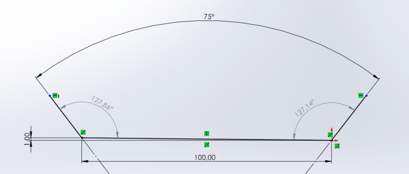

See the image below for a worst case. Here the bent edges are at the 5deg from nominal, but even with the base at its worst allowable perpendicularity, the angle relative to the base is within 0.72deg. Note, the perpendicular tolerance will allow the horizontal line to slide anywhere along the wedge formed by the datum. A profile control in addition to, or in place or, the perpendicular control may be appropriate. Depending on your needs, this could be measured with some accuracy using a digital protractor. This method effectively allows the arms to bend symmetrically but like I said previously, it's may not be appropriate depending on the function. If all you're worried about is where the center of the arcs end up relative to eachother, then this probably isn't the way to go.
EDIT: A similar effect could be achieved by directly tolerancing one of the angled faces to the horizontal one adding x2 to make the specification symmetrical (eg. 2x 130deg+-2.5deg). Then you could add a note saying the angles must match each other to within 0.5deg, but it's not really a GD&T solution.

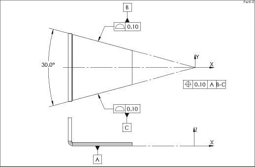

Under ASME Y14.5, my interpretation would be that datum A-B is a combination of two planes and a line: the two wedge faces would be "contacted" by two theoretical planes at the basic angle between each other, simulated by the inspection equipment, and the intersection line between them would be part of the datum. Then a bisecting plane between the said planes and through the line would be established, to be part of the datum reference frame. A second plane of the datum reference frame would be established through the intersection line and normal to the first plane. If A-B is referenced alone in a feature control frame we wouldn't be concerned where exactly the third plane of the datum reference frame is, but it would be out there, perpendicular to the first two, and anywhere in the "depth" of the part (into or out of the page in the shown view). Finally, these 3 orthogonal planes would define the origin and the axis system used for the geometric controls that reference A-B.
SeasonLee,
I think in the figure you posted, the two profile feature control frames that control the secondary common datum feature B-C miss a reference to the primary datum feature A.
Also if this drawing was per ASME-Y14.5, I would make the angle basic and then the angular relationship between the two sides of B-C would also be controlled by the two profile FCFs that would reference A (due to a Simultaneous Requirement).

My main worry is that the profile will be overly asymmetrical (like the red lines as opposed to the black lines) and thus where the center of the arcs end up with respect to the (theoretical) centerline of the part.
For now I'm guessing this will be my best option:

I've been considering your proposal further and want to explore this more. I think doing the constraint in the manner you have posted - while correct and clear - may restrict tolerance zone more than required. As an example: for the part to function, the tolerance could be +-5deg from the horizontal face to either of the angular faces, but the angles need to match within 0.5deg of each-other (ie. if one is exactly 130deg, the other could be anywhere between 129.5 to 130.5). I think the way I proposed the tolerancing would utilize the full tolerance zone. If constraining the datums to basic profiles it would lose out on a lot of the available tolerance.
EDIT: I was considering this in the context of using the profile with simultaneous requirement to define the faces of datum A & B. If, in SeasonLee's example, the FCF on the face of Datum B was referenced to datum A and had a wider tolerance then I think that would maximize the tolerance zone when referencing A-B. I think relying on simultaneous profile would require a much narrower zone than this approach.
